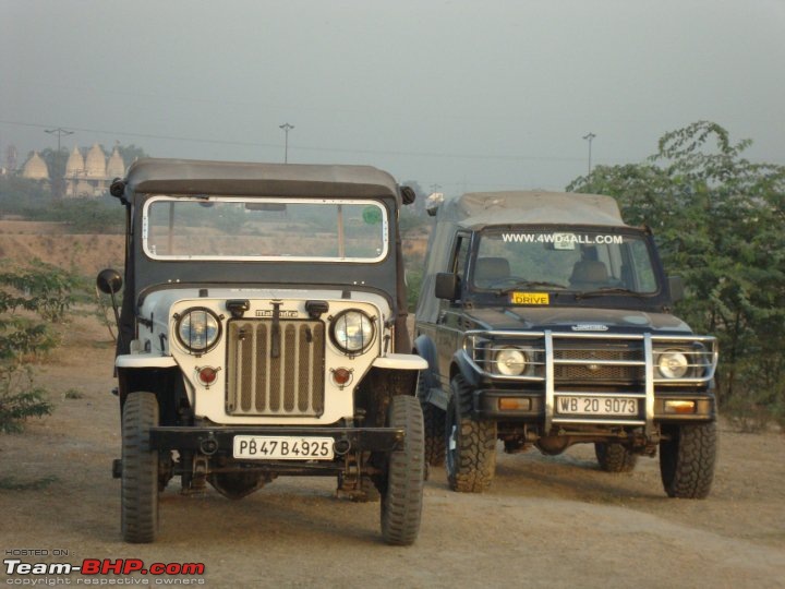

I think the 1.8L Isuzu is the most difficult option of the 3 choices and the increse in power over the 1.6L (with custom FFE and Headers) is not much whereas the cost is the same. Anyway, I am waiting for the diesel mill to get sold off first. What do you think?
Lock Right Lockers are sitting on top of my cupboard for the last 3 months waiting to be fitted. Since I had changed the tyres to Savero MT, I wanted to get used to them in OTRs before I went for the next upgrade... and then i just got lazy. Will fit them before the monsoon OTR season.
Crawler gears are also on the wish list but only after i have fitted the lockers and got used to them.
Ankit
Originally Posted by ex670c View Post
Hi Ankit,
You can even opt for a 1.8L Isuzu MPFI and Gearbox.
Dwarka from Bangalore has done a similar upgrade.
The 4WD can easily be retained because the T-Case is divorced.
Arka
PS - Add to that 4.16:1 Crawler Gears & Rear Locker
