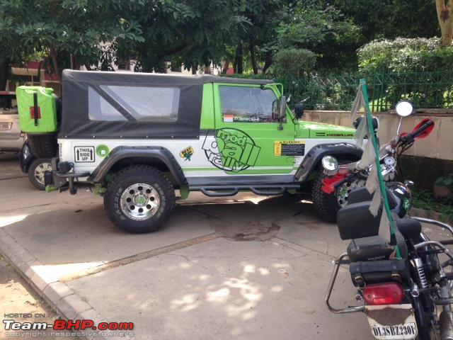

A quick background about myself to all fellow BHPians. I live in Gurgaon and have been a passionate follower of TeamBHP since a kid and have been working on all sorts of mods / cosmetics of all the cars my family owned (Scorpio,Esteem and Bolero) since I grew up in a joint family and a defence background.This is for the first time, I picked up a project of making a strong off-roader for my touring purposes and picked up a disposed army vehicle from HP state (2002 Gypsy King) and have been working on this piece since last one year. currently it has a 1.6L Baleno engine, however the performance is quite underpowered and expensive mileage. I have been looking for a new / good toyota C2 Turbo Charged engine transplant for my GypsyKing 2002 model and hence need your help with the following questions -
1. What are the ways and venues where a good condition engine can be procured apart from visiting Mayapuri (P.S - Have had some pretty bad expereinces there..)
2. Just to confirm, will i be able to retain 4X4 capabilities once the swap is made.
3. Apart from the engine, what are the other components that would have to be assembled once the engne has been installed.
I would be grateful for your responses
