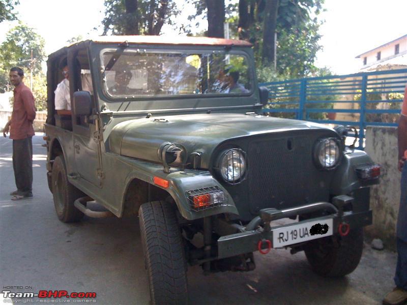

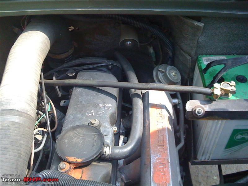

As a jodhpuri fren of mine has a collection of such odd mods. The only two vehicle i really liked was a 550 with nissan engine mated to isuzu4x4. and another a 550 now with a nissan diesel.
