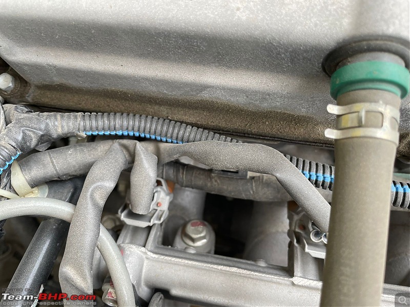

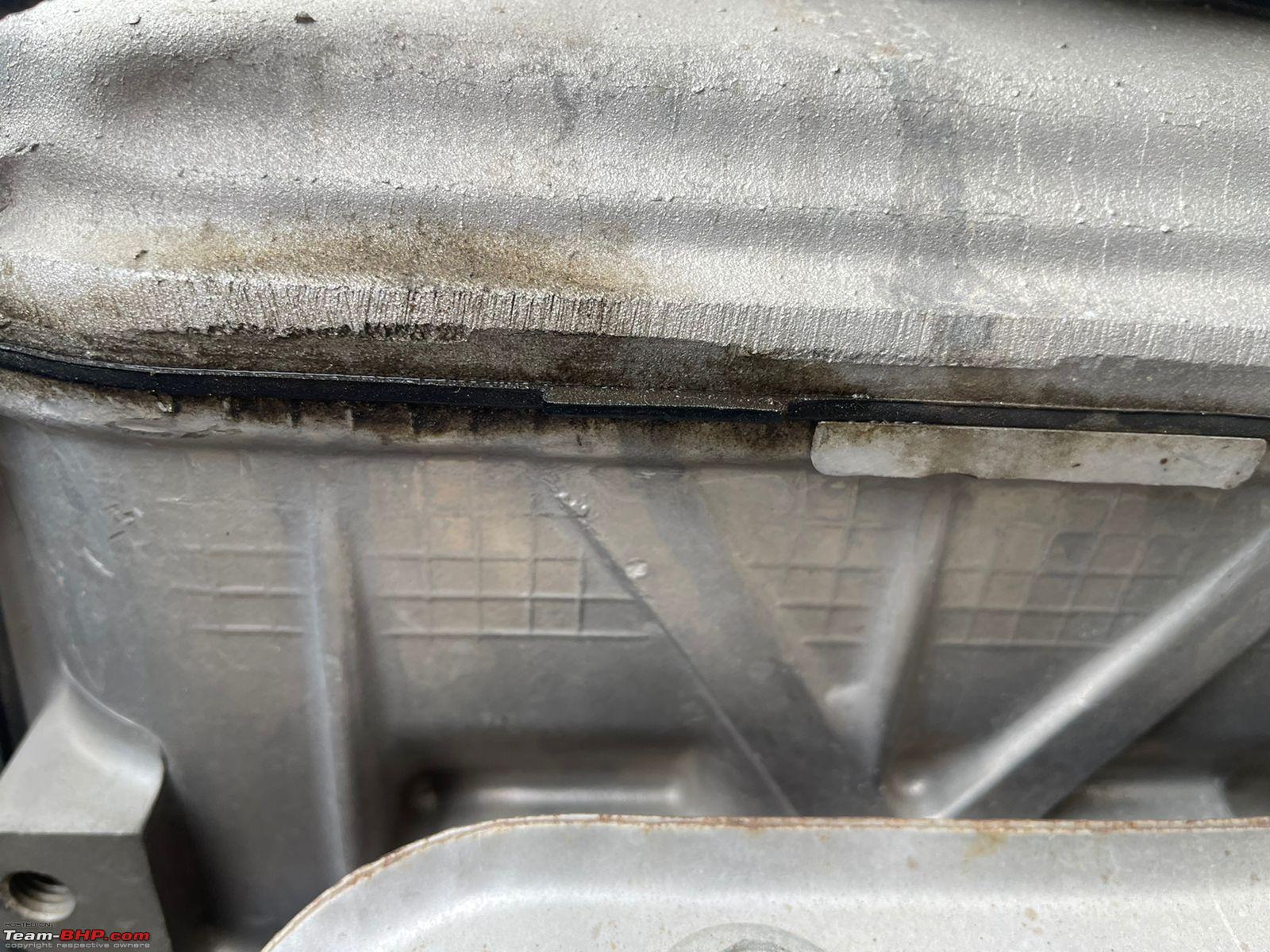

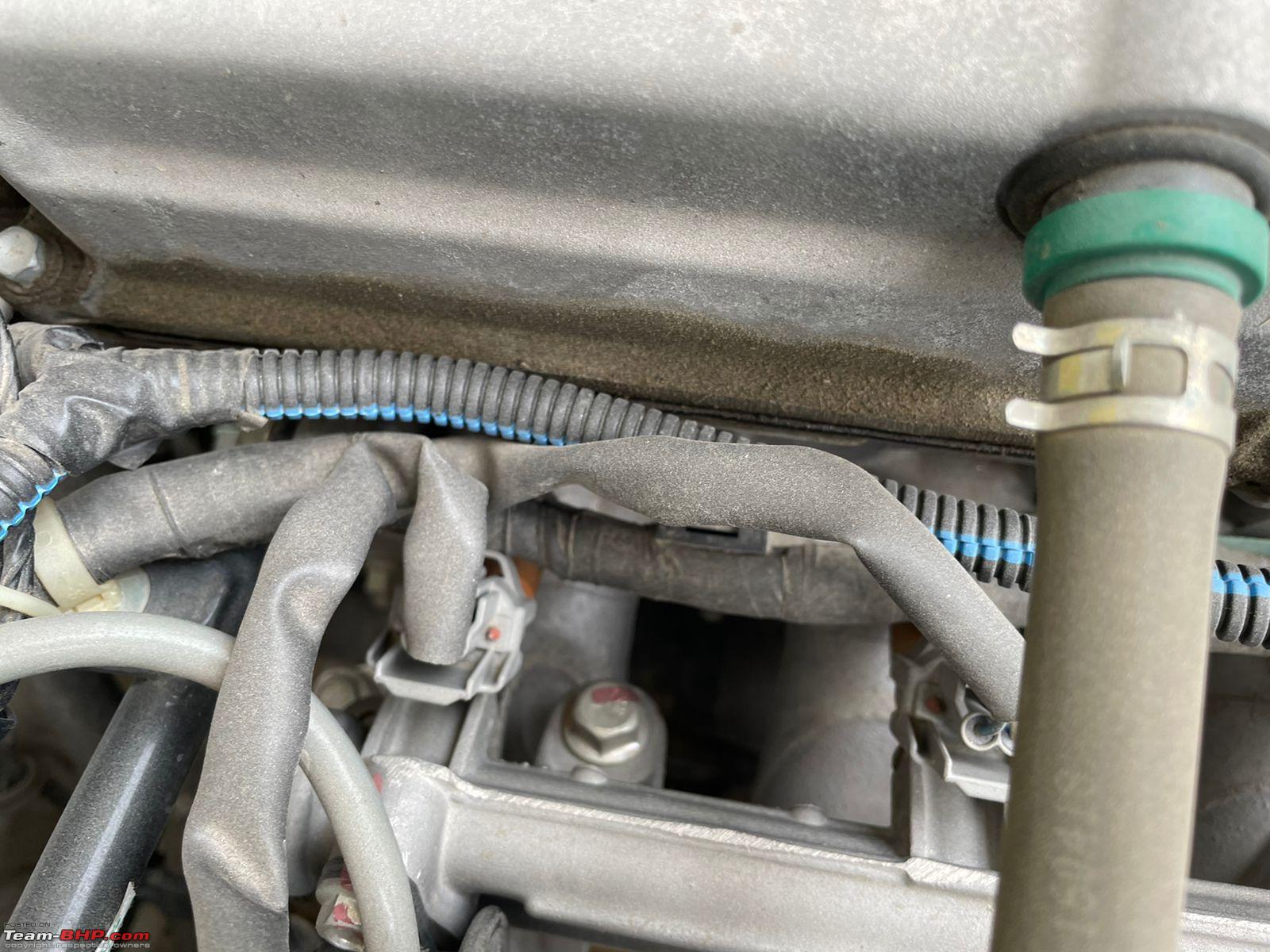

Noticed dust deposit near head gasket area of my 22K run gypsy. Looks like minor leakage of oil. Or this normal. Pls advise . Pics attached

That's not the head gasket, its the camshaft/valve cover. Make sure bolts are tightened according to spec. If need replace the rubber seal. This won't cause much issue though.
Also if somebody had filled the oil, spillage from filling the oil may settle there on that gasket area and when it dries up with dust, you get such a appearance.
