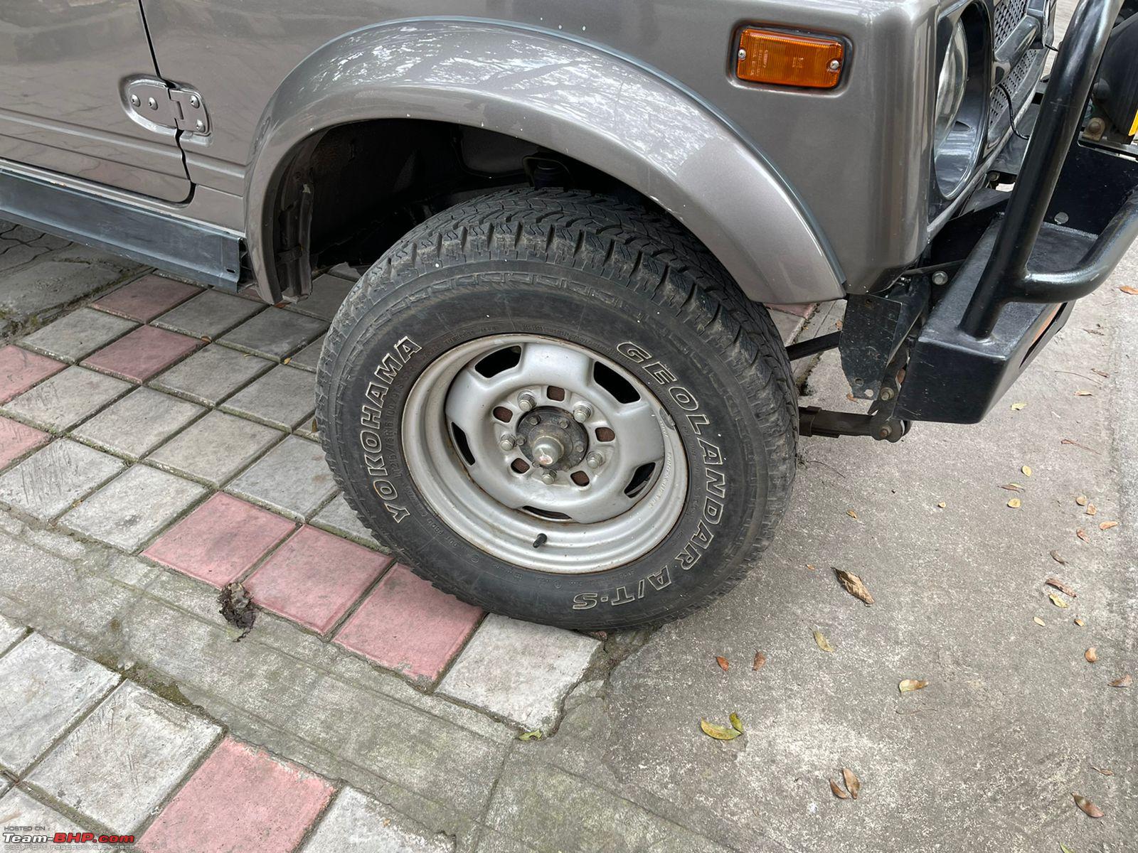

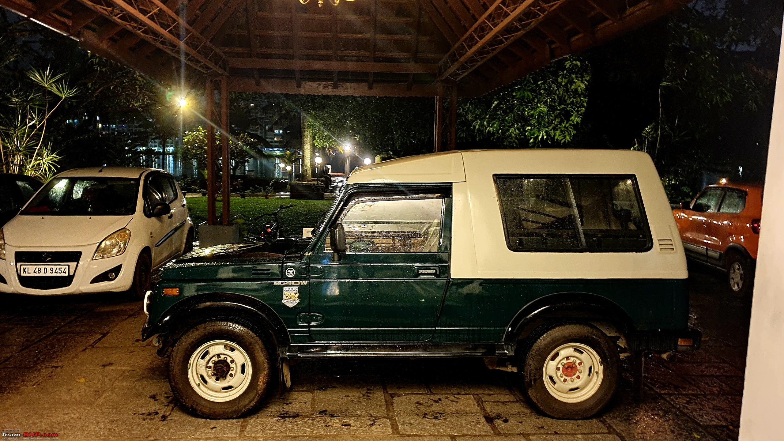

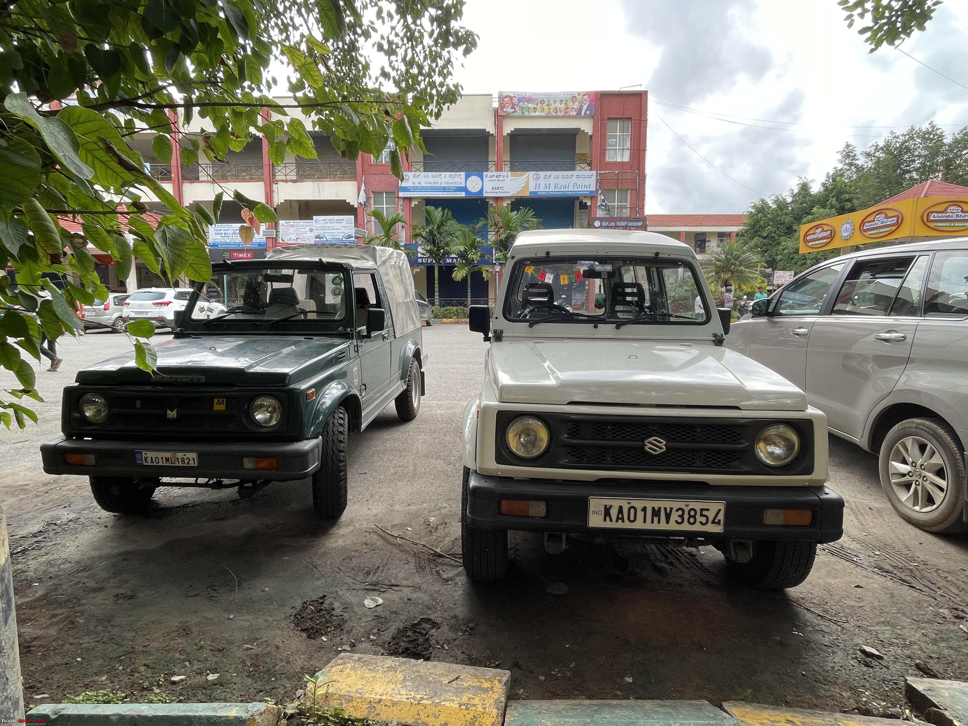

Yes, seeing that. also good that the rear seats are foldable, and this helps.We checked out one yesterday with 215mm MT tyres. The tyres were rubbing against the corner of the pipe behind the bumper.
Yes MT tyres will tend to rub because of their aggressive big mud plugging tread sipes. AT will be very close too. This is why usually people fix the typical off road bumpers along with the upsize to 215 size MT tyres. My green gypsy which is now with Bibendum had this combo. Many people go even more aggressive and put 235’s and all. But usually these are accompanied by a 2 inches or 3 inches Lift Kit and dog bone shackles and all.
Personally I find all of that unappealing, preferring to keep things stock.
See the pics.
The white gypsy is a local friends gypsy which presently has Yoko Geo AT in 215/75/15 and these dont rub at all.
The Green Hardtop is Bibendums gypsy which has the off road bumper and Goodyear 215’s which I had put. It doesnt rub.
And the other green is mine which uses stock nylon tyres.
Look also at the cool white gypsy which was cool_dube’s in earlier days. That also had Yoko 215’s which didnt rub. And the other brown one which I had evaluated in Dec 2021 but didnt like because it was too modified.
Remember also that apart from a lift kit and off road bumpers, when you put very large tyres they will also rub against the leaf springs when the steering is turned.
