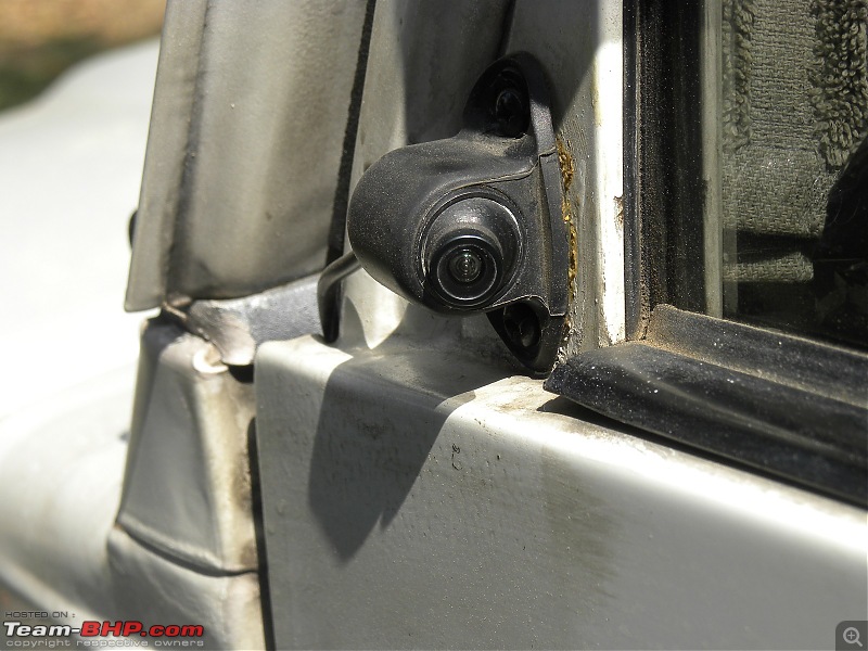

Old 8th September 2022, 20:37   #809

Re: Maruti Suzuki Gypsy - Queries
Originally Posted by SJ410 View Post
Yes. The basic design is very versatile with two degrees of motion.
Please share some pics of your rear view cam and side view cam setup.
Thank you, SJ410! I have changed so many mirrors that I am tired of buying them -- they all come loose at the bottom, not at the ball joint. Even if it happens at the ball joint, it is easier to retighten with a screwdriver.
That is another beauty about the GYPSY MIRROR -- it is inflation proof, at least in Calcutta ! The first one I bought in 1987 while rebuilding my JONGA cost me Rs. 80/-. The latest cost me Rs. 85/- in 2021!
Here is a pic of my side view camera, bought from Amazon. The rear view one is the standard hole in the bumper type. Its monitor has ports for another device, where I fitted the side-cam jacks.
Last edited by SnakemanJohny : 8th September 2022 at 20:38. Reason: Wrong spelling
SnakemanJohny is offline   (2) Thanks

Hey SMJ, yes, that is the beauty of simplicity.
Wow. 1987 JONGA. One hardly sees them any more. I remember how 'silent' the engines were when they would speed by in the cantonment areas. The only sound that could be heard was of the tyres on the road.
SJ410 is offline
