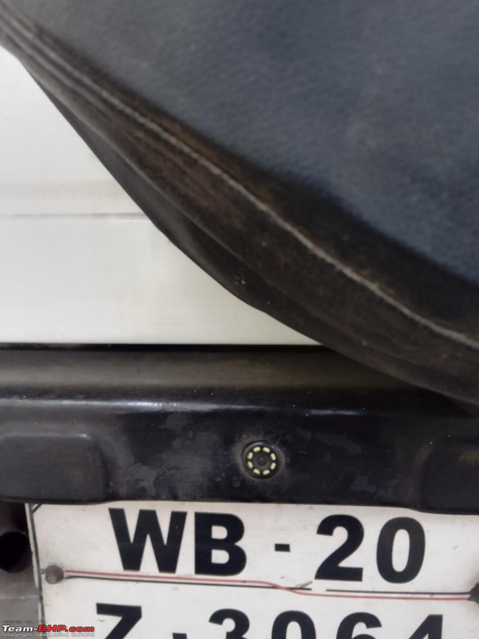

Sorry for the delay, SJ410. I do not use a smartphone (so no camera), and my old-fashioned camera has gone for repairs !
The rear camera has been mounted on the steel bumper centre, and this involved a lot of work : the enclosed hole saw could just mark the outline before going totally blunt -- it is meant for plastic bumpers only !
Increasing sizes of drill bits were used, to finish with a half-round file. But the connection to the reversing light was easy -- being housed in the bumper itself.
The rear door would have been slightly easier to drill, but the wiring would have to be more complicated.

Reversing Gypsies with front facing second row seats are a problem, I agree.
You can choose either a camera with a separate dash-mounted monitor, or one with a wider IRVM which clips over the standard mirror. I have the first type. Rear sensors were fitted first which beep, talk, and show distance on the clip on IRVM, which is also tinted for night driving.
Both kinds should be available in car-deco shops. I rely on Amazon for a w-i-d-e variety, and fit everything myself.
