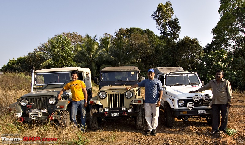

Now for the group shots. The Udupi Offroad team of two drivers (Sachin & Sharath) and a master mechanic (Prakash Poojary) who keeps these machines chugging along. He has overhauled the engine of all three vehicles, apart from transplanting the Qualis engine into the MM550 and making the un-serviceable Gypsy very very serviceable.

Now the MM550 has lockable front cabin, with AC and music system.
