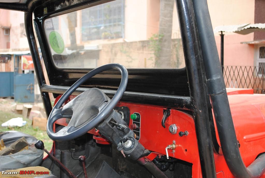

i have the post23 walla by fazal. only difference is it is not hidden in then firewall. I have it bang on the dash right below the data plate. I just take away both the JAY ignition and this thick battery cut off switch.
http://www.team-bhp.com/forum/attach...0-dsc_0100.jpg

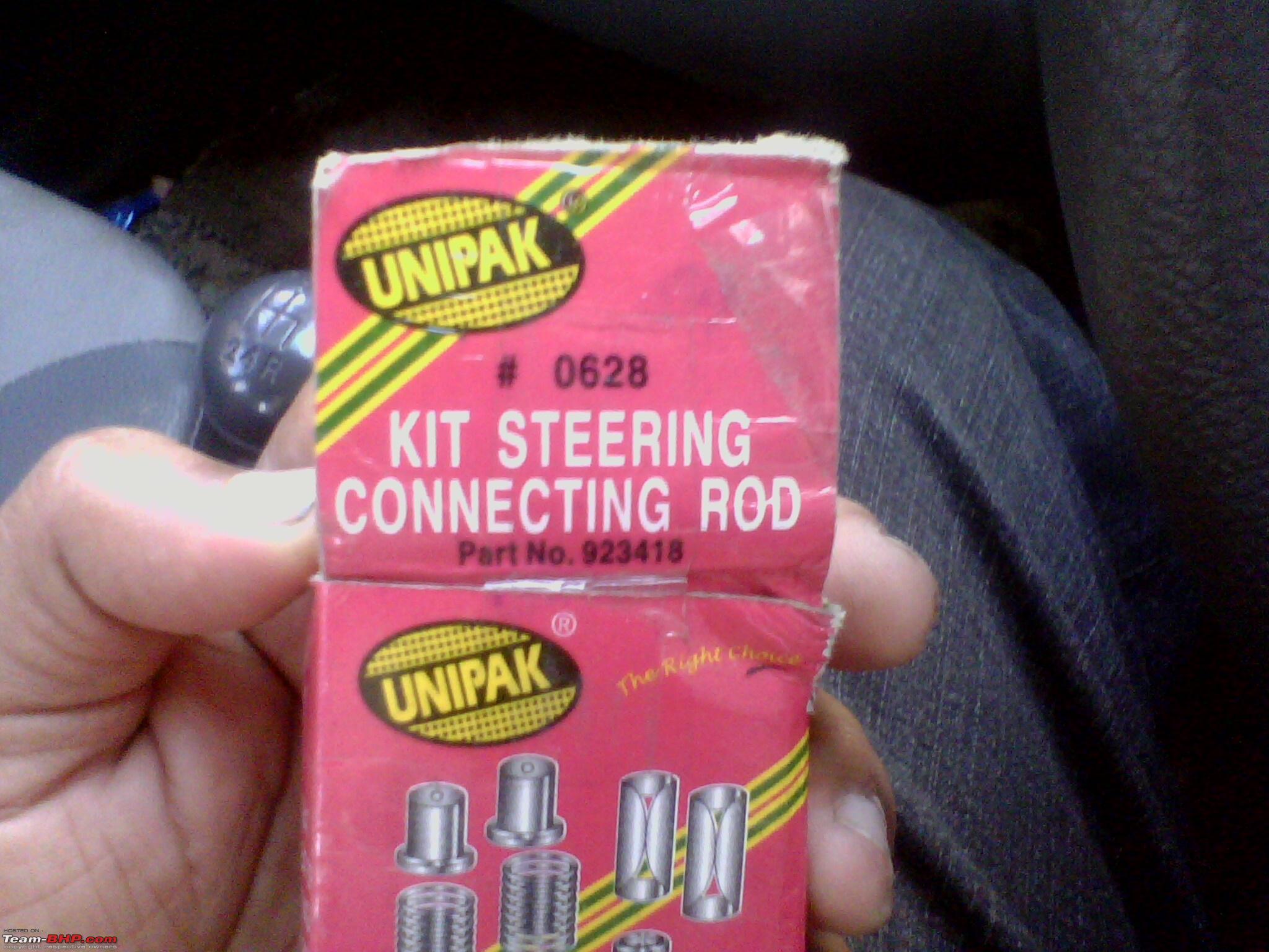

1) UNIPAK Kit Steering Connecting Rod - Part# 923418 --
This kit consists of around 15 tiny parts. This Kit is used in the 'connecting rod' that connects the stering box to bell crank (nearly all old jeeps). There is also 2 grease nipple points in the con-rod. This kit helps in damping/reducing play in the steering wheel and if any part is missing - it will cause a kat-kat noise when turning the wheel.
I had a case of very loud KATAK sound on any left/right turns - cause was I had less than 8 pieces of the whole kit left after the recent rebuild. When the tinker had removed the tub (& steering box), he put back only what he thought was needed!!!
