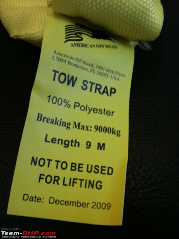

Shibu, aka JeepCaptain sent me the following from Dubai, via a friend.
- A kinetic energy recovery strap (my chassis thanks you my friend)
- Grab handles (will be very useful once i get the roll cage ready)
Thanks a lot Shibu.

Awesome stuff. Im going to Dubai next month, will pick these up too. Im sure Shibhu knows what hes doing. Also awaiting your report on these things. Tejas, why are you getting a custom roll bar fabricated, you think that the original one on the classic is not good enough? Asking coz i am on the verge of getting a classic bar and the hood with doors for my CJ.

No problem Tejas. You are most welcome. Anything for Jeeps and Jeepers.
Now waiting for the report of your kinetic strap and grab handles.
