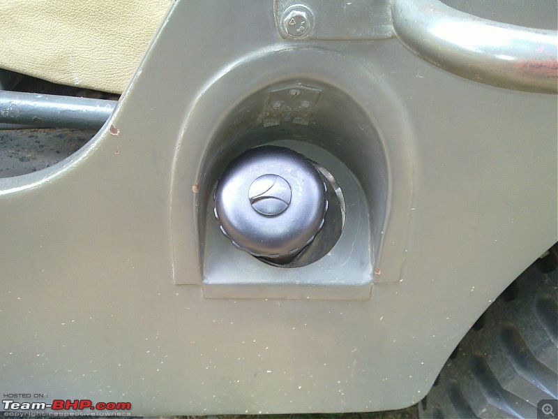

What is wrong with the fuel tank?
I fill only 500 rs worth of petrol each time cos the fuel leaks from the inlet end even though I have put a new cap and also lined it with polythene bag neatly, but I guess it still spills over. So the cabin reeks of petrol smell. and even I catch the smell on my clothes. So all the CK's and Dior's on me smell like petrol!

Hi Shubz,
This is a common problem with CJ3B / 500Ds. Try doing the following :
1. Add a rubber beading in the existing cap.
2. Try pushing in the lock lever a bit downwards so that it holds the tank neck tight when locked.
3. (this method was taught by Arka, thanks to him) Tie a plastic disc at one end of a thread and insert it inside the tank. Get the other end of the thread out of the fuel tank and tie it either on the rollcage.
If not sure about method 2, pls post a pic of the tank neck and the inside part of fuel cap so that I can explain.

Sabareesh sir,
Here are a few pics of the fuel tank opening.
thanks,
Shub

Regarding the petrol cap leaking, you can never stop it unless you put a Jeep's cap. These Ambassador caps modified for the jeep tank are good if placed at a height. The jeep caps came without a key to lock.
