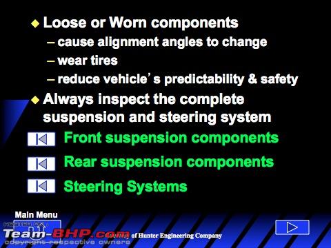

Originally Posted by Ravibm
Please start to understand that Alignment is only one of the parameters that will affect the tyre wear.
Alignment reading being all green generally means there will not be any wear and tear due to misalignment. But this does not mean it is immune to the rest of the factors. Example – Just low inflation or High inflation can cause the tyre to wear on the edges which has nothing to do with Wheel Alignment.
Rear Wheels or front wheels do need to be within in the Manufacturer's specifications to get an understanding that this is what it was designed to. In this, we also need to take care of the Cross camber or Cross Caster which means the difference between left and right readings. This also should be within tolerance.
Front Toe readings should be read as " Front Total Toe" as a very important spec. Individual toe may be out but Total has to be correct. If total toe is out of spec it will cause tires to scrub and wear out faster.
Rear Toe readings are very important to understand the Thrust Line or Thrust Angle of the vehicle which will decide how the front toe will be set. Here the individual toe of the rear wheels are measured and the Thrust angle is arrived as the difference betweent he left and right toe readings of the Rear wheels
No single complaint can be diagnoised in a very simple way. You need to take many factors and then come to a conclusion as to the reason for the complaint. It can be one issue or multiple issues in a car. Alignment is one issue, but there are many other issues like, Strut, Bearings, bushes, tie rod ends, Ball joints, Tyre inflation, broken or damaged parts etc.
I would conclude it the following way.
If you are a doctor and want to diagnose a patient who comes with a cold and fever, what do you do?
He can be having the cold due to congestion in his chest. He can be having a fever due to this or he many have other infection like a cough or throat infection. We cannot treat all of them the same way. For cold and congestion you have different medicine and for Throat infection you have different medicene.
You need to treat your car like a human body and then come to a final conclusion.

PeralJam ---- The rear toe is usually done through adjustments at the service centre but could also involve replacement of some parts.
It is not that expensive. Compared to a regular alignment at a tyre showroom like ours, it will be more expensive but they have the required expertise and tools and they may charge you around 1000/- for a total alignment. Being Maruti, it might be even lesser than that.
