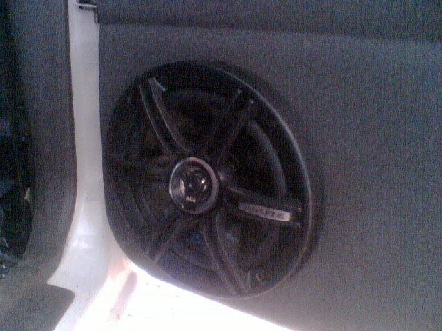

Speaker installation
He made a nice padding for my front doors using MDF, installed the velocity woofers into it.
Left
Right
And the tweeters were installed in the A pillar.

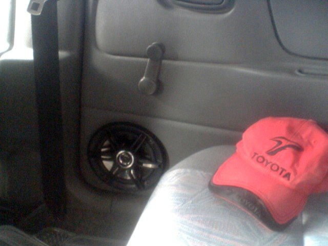

For the rear, I wanted to install Blau 6X9s. But could'nt find a suitable place for doing it and I did'nt want the soundstage to be shifted behind also. So, we decided to stick with the alpine co-axials. Those were placed in the rear doors.

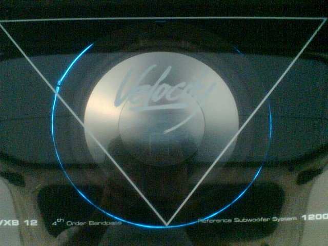

SubWoofer installation
Subwoofer was kept in the boot as before and the connecting cables were changed to monster cable.

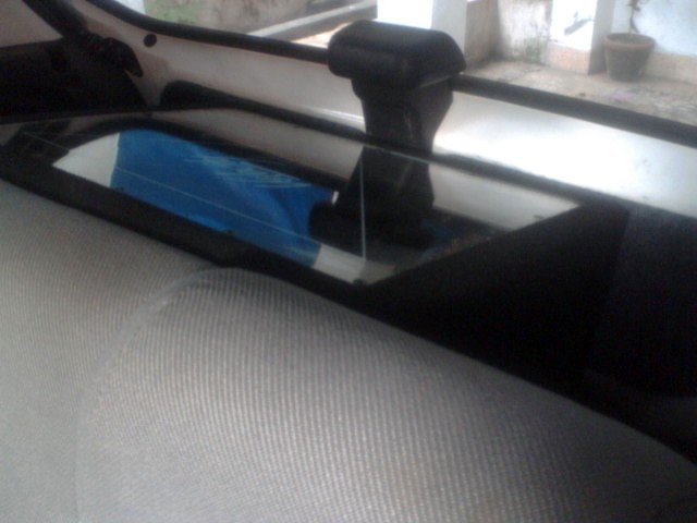

From inside the car:
Boot open:
He also put a blue neon light wire inside the glass enclosure surrounding the SUB. It pulses according to sound. Looks really cool ! !

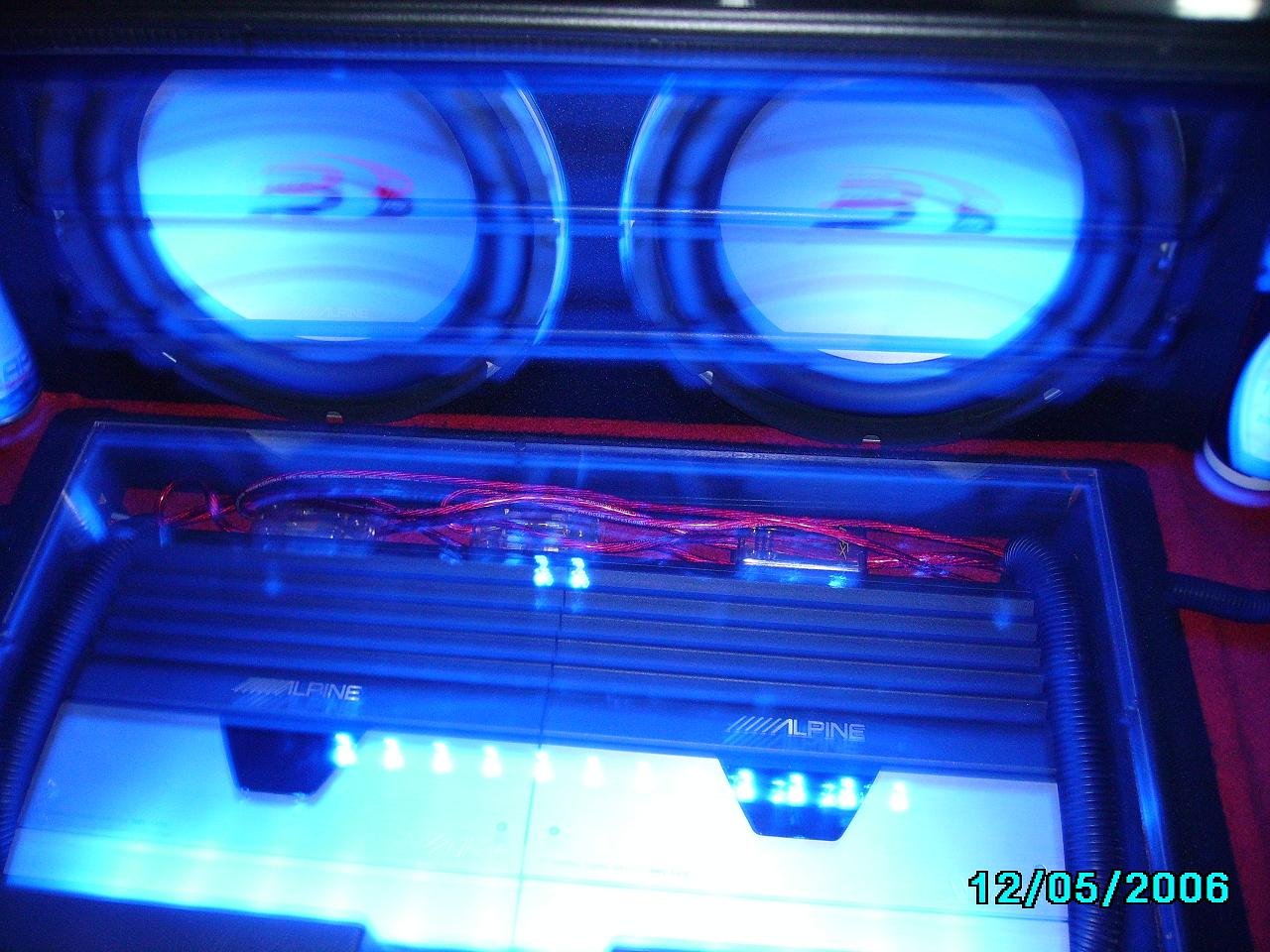

Amplifier installation
The Alpine 605 monoblock amp was fitted beneath the driver seat and carpets were arranged to make airflow to the fans. The Amp has a hood which itself is a protective cover from dust and other nuisances. The controls are fully digital and no fooling up with the settings here. It also has a blue backlit digital display which looks really cool.
