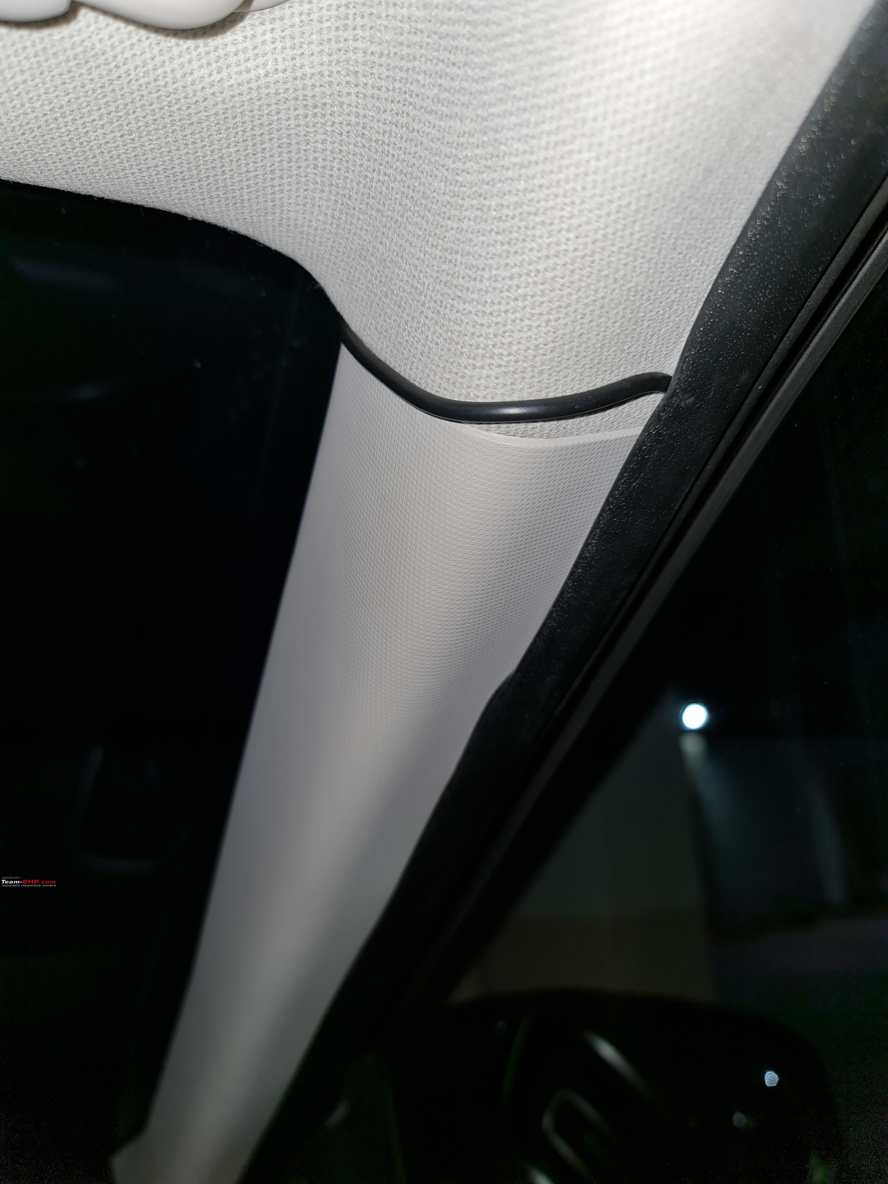

As for the wiring it is concealed expect for the bit around the A Pillar.
The Dashcam / Car Video Recorder (DVR) Thread-11_wire-under-insulator.jpg
