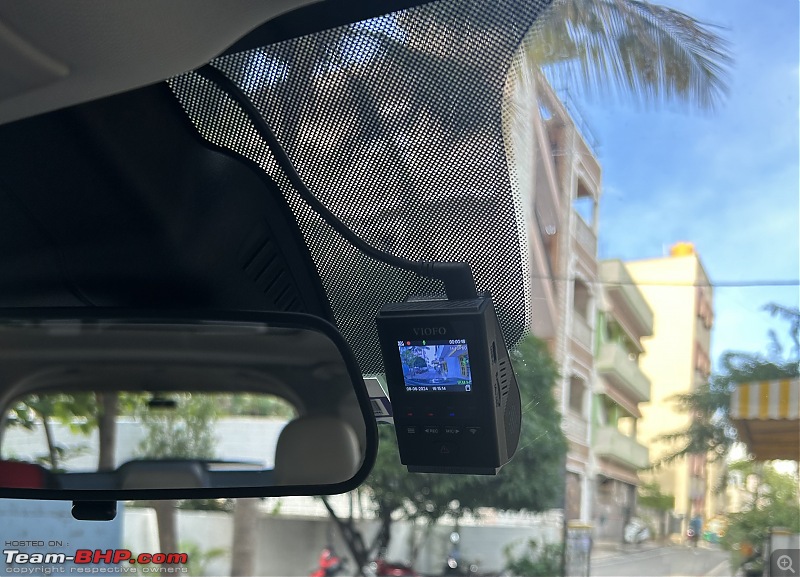

I recently replaced my 7 year old Yi Smart Dashcam with an ‘Viofo A119 mini 2’. I wasn’t happy with the details my old cam could capture, especially after a recent incident where I couldn’t get the number plate of a Brezza that was driving wrong side on the Bangalore Mysore Expressway. I did a lot of research and narrowed down to Viofo A119 mini 2 as this was the cheapest one with a 2K Starvis 2 sensor. There were a lot of credible reviews from US based reviewers who are usually more technical and are not doing marketing gimmicks unlike many Indian reviewers.
Most of the other dashcams in this price range had starvis 1 or are were not specific about sensors. Many had upscaled resolution advertised too.
I didn’t go for a dual camera as I already have a basic but decent rear cam and want excited about routing a cable all the way back. Also, it helps in ASCs 🙂.
Camera is wonderful except for the dashboard glare. I will live with it than going for a 2.5k CPL filter. I installed it on the black ceramic painted area of the glass on driver side and routed the cable perfectly concealed around the passenger side. This meant I couldn’t use the static sticker too. I couldn’t install it on the passenger side as I wouldn’t be able to install it high enough to be concealed as the power cable wouldn’t fit due to the ADAS module which is towards the passenger side. This in a way helped as I can reach the camera when needed and, it being small, doesn’t cause much obstruction.
The Dashcam / Car Video Recorder (DVR) Thread-img_4289.jpeg
I purchased from Viofo.in where the seller was giving an additional 1000 off on UPI payment. You can contact them from the site using chat.
A few tips while choosing Dashcam.
  • Look for Dashcam with Starvis 2 sensors. Their detail capturing ability and WDR are a class better than any other sensors, including Starvis 1.
  • A lot of cameras in Indian market doesn’t advertise true resolution but upscaled resolution. Verify against the sensor spec. In most of the cases, you just need a 2K camera with a good sensor.
  • Avoid cameras with Li ion battery and choose those with super capacitors.
  • Many dual dashcams comes with 1080p rear camera. A separate rear cam may be economical, better quality and gives you redundancy, better if you have provision to install it separately.
  • Try to assess the reviewers based on the technical details they share. Many reviewers are just influencers looking for affiliates commission.
