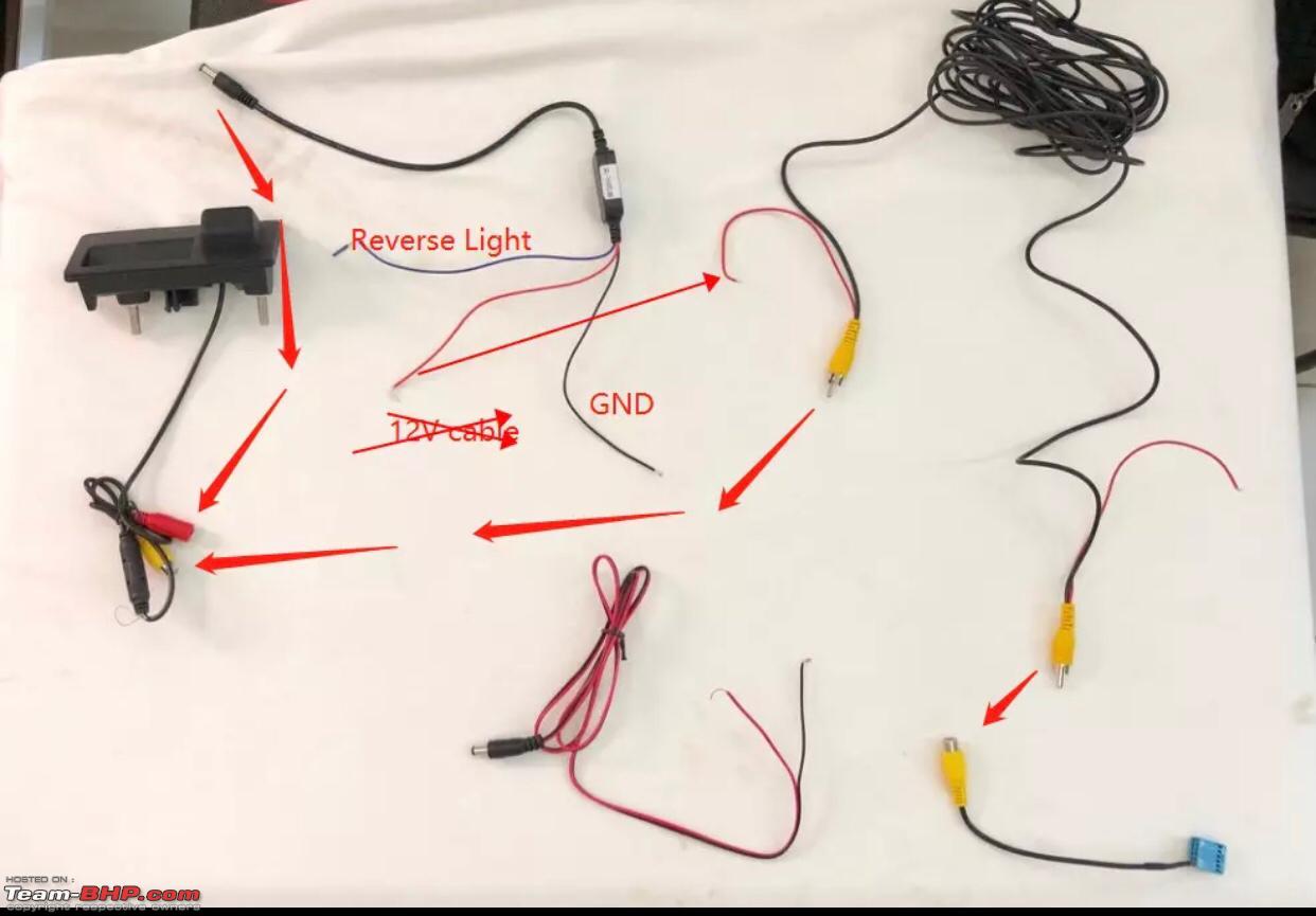

Old 3rd October 2019, 10:08   #412
z klasse's Avatar
Join Date: Jun 2004
Posts: 351
Thanked: 28 Times
Re: VW Polo/Vento : Replaced stock RCD320 with RCD330 Plus + rear view camera installation guide
Originally Posted by acemanhiflier View Post
my conclusion is that the OPS does not work on RCD units in Jetta TL or CL variants. may work in the HL variant. that said, the 187B is an excellent unit by itself, especially if you use Android Auto. the sound quality is also pretty good.
Agree on this.. The sound is surely much more better than the RCD510. I am unable to get the camera working. Have done pretty much all of the right connection. See the diagram below:
VW Polo/Vento : Replaced stock RCD320 with RCD330 Plus + rear view camera installation guide-whatsapp-image-20190917-3.55.32-pm.jpeg
z klasse is offline
Old 3rd October 2019, 10:23   #413
iTNerd's Avatar
Location: Imphal/Noida
Posts: 1,241
Thanked: 1,214 Times
See below:
Check if A is connected to Power in your fuse box. And that E is correctly connected to the reverse light
iTNerd is offline
Old 5th October 2019, 05:44   #414
Join Date: Nov 2013
Posts: 69
Thanked: 22 Times
I have a Jetta TSi CL and have tried everything with similar stuff. But somehow the camera just does not work with 187B or A HUs (have both, former fitted in my Jetta and latter in wife's Polo). Something to do with signalling on the CAN bus.
In fact, none of the HUs is addressable on CAN bus using VCDS when fitted in the Jetta. They seem to be able to communicate only partially in the Jetta. However, both are addressable in the Polo. So I temporarily fit the HUs in the Polo to make any changes to settings using VCDS before trying/fitting them in the Jetta.
I have checked the video output of the camera on the Jetta, and it is fine. Have tried all possible settings in 187A and B through the Polo. But no camera video on the HUs.
acemanhiflier is offline
Old 5th October 2019, 09:14   #415
z klasse's Avatar
Join Date: Jun 2004
Posts: 351
Thanked: 28 Times
Apparently its a known issue with these camera's and I think you need whats known as a CAMERA ACTIVATOR. This is something that was informed to me by my friend who installs on many cars. I am going to check with this and see if it works.
z klasse is offline
Old 6th October 2019, 00:28   #416
iTNerd's Avatar
Posts: 1,241
From what I recollect, for the OPS and camera to work, the gateway module needs to be upgraded to the one in Highline variant. In my Yeti elegance, it works without any issue (with the time delay box).
iTNerd is offline

Old 9th October 2019, 11:34   #418
z klasse's Avatar
Join Date: Jun 2004
Posts: 351
Thanked: 28 Times
is anyone able to address 187A or B on CAN bus in Jetta TL/HL and change settings using VCDS?
So I got some details from one of the seller. He said if the car already has the blue plug in the ISO connector, then you need to remove the red and black cable of the camera connector and put it into the existing blue plug. See the image.. Red is Video Positive and Black is Negative.Going to try this out soon.
VW Polo/Vento : Replaced stock RCD320 with RCD330 Plus + rear view camera installation guide-h7e3ed3c7f1824803b723700299bb5d261.jpg
VW Polo/Vento : Replaced stock RCD320 with RCD330 Plus + rear view camera installation guide-whatsapp-image-20191009-11.29.45-am-1.jpeg
VW Polo/Vento : Replaced stock RCD320 with RCD330 Plus + rear view camera installation guide-whatsapp-image-20191009-11.29.45-am.jpeg
z klasse is offline
