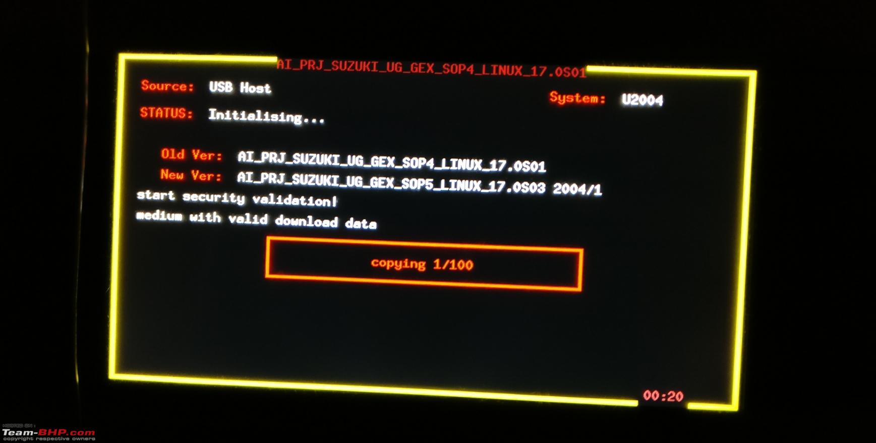

Got my May 2016 Brezza updated with the latest software 1750 today. It supports Android Auto perfectly unlike 1740 wherein the screen used to go blank when someone called. Detailed testing tomorrow.

I got my baleno updated with 1750.2 yesterday. As of now no issues seen and android auto works flawlessly. It is a two step process. First flash fails at 85% (if I am not wrong) and second time it goes till 100% and completes.

Got my RS updated, everything is working great. As mentioned earlier the update fails the first time at 75% and completes the second time around. Took about 30 minutes.
