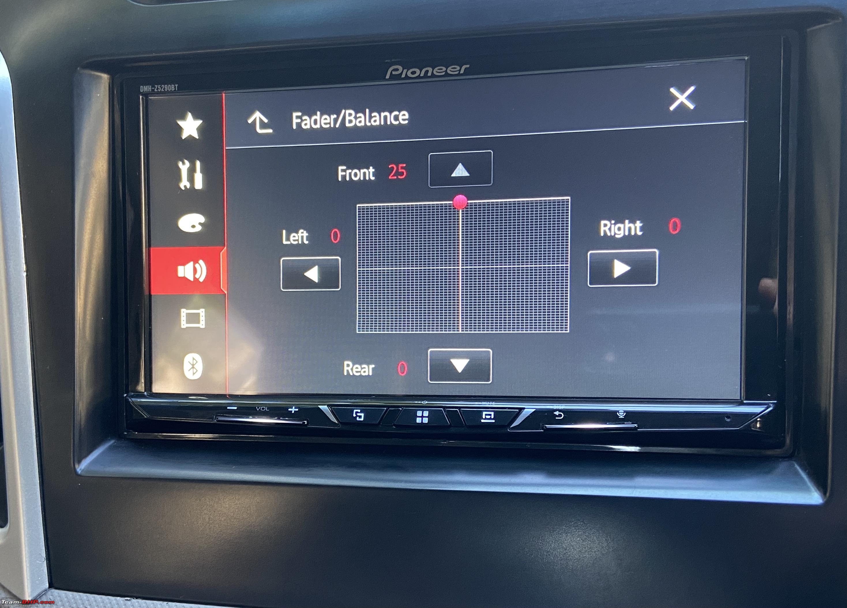

capcitive vs ressistive should not be a huge difference for this kind of resolution and usage.
I mean there are large icons and menu text. users are not supposed to be dealing with the advanced gestures and response in the headunit screen. unless one plans to browse or play games in your headunit.( which you cannot anyway ��)
As shared the touch of pioneer is far better than what stock unit offers.
Also, in pioneer there is video out to which one can connect a full HD screen for passengers.
For me the biggest differentiator was sound and tweaking capability . Have a look at what pioneer offers in a 19k priced unit.
a. Time alignment and preset for each listening position.
b. Crossover with slope of 12db/ 24 db and even 36 db per octace.
c. Calibration using external microphone is also an option.
d. 13 band eq.
and more ..
