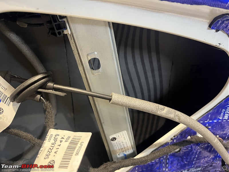

Doors with dampening. There's an additional layer that I have no pictures of.
