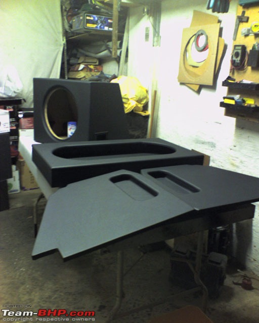

the install was done by a buddy and myself, since i wasnt familiar with how the car opened up - my previous installs i had done mostly myself since i knew the car well, but for this one i was forced to get some help
heres a picture of some of the build up process and some parts that were covered with vinyl, in my new install anything being covered will get done by a pro upholsterer in identical leather as the seats
the subwoofer enclosure built out of MDF - totally custom built to fit within beauty panels

all the covered parts laying on the table prior to fitment

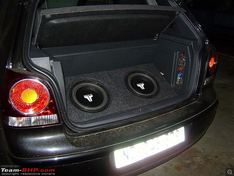

the JL audio subs

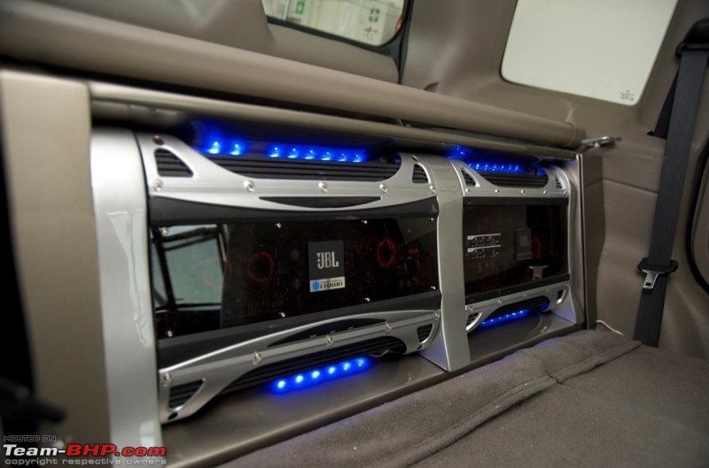

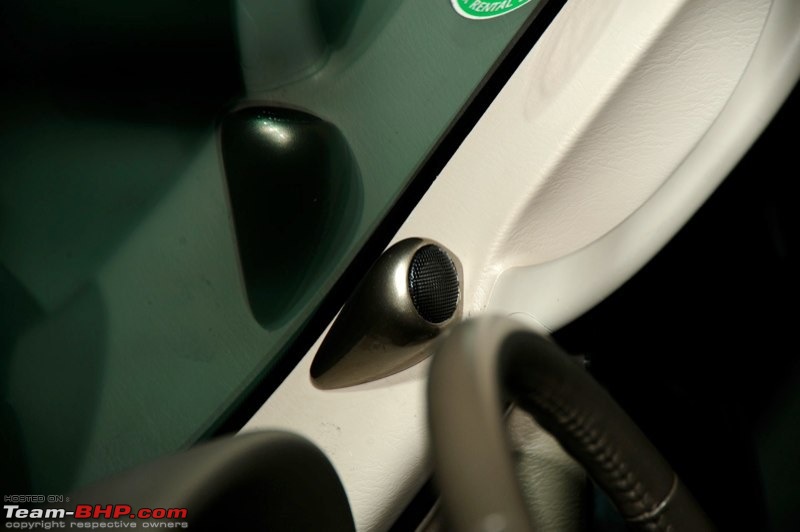

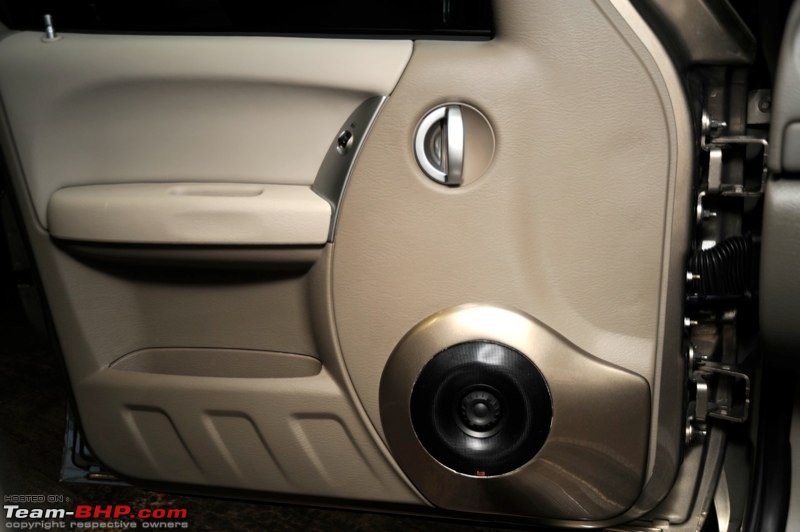

the W15GTI sounds incredible as does the W12GTI. My good buddy Pravin Bhicka who is an audio retailer here has a complete JBL setup which is amongst the best setups ive ever heard - and his setup looks amazing as well
heres some pics of his install - sorry for the but this install is one of my inspirations when it comes to installation
the W12GTI in the hatch of his Jeep Cherokee
when you drop the seats, this is his amp rack

fibreglass construction of the door cards painted to match the bodywork of the vehicle

tweeter pods in the A-Pillars
