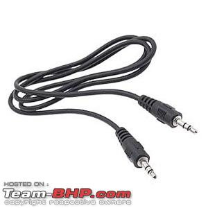

Originally Posted by swarnava.m (Post 3005282)
Your post is slightly unclear. Let me get this straight. There is a cable that has 3.5 mm male connectors on both sides, looks like this:
Attachment 1033727
Am I right?
If yes, then where does this connect to in your player? Or, where is this supposed to be connected?
In the picture, it is a concealed stereo cable with 3.5mm jack pins. On your Audio Head Unit (AHU), there should a 3.5mm jack, looking similar to your walkman or one that you see on a phone jack. Some AHU's come with front and rear AUX inputs as well. You may use this cable to connect your Cell Phone's or MP3 Player's audio out connection and put your AHU on AUX1/AUX2 source mode.
There is one more fitter at Madgaon before entering the Garden (should be near AXIS Bank ATM) while coming from Fatorda. Which is the Head Unit you have finally decided and where are you fitting it in Madgaon?
