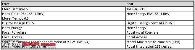

Hi,
I am looking for some help in identifying replacement for OEM speakers in Vento. I have read the entire Vento ICE upgrade thread and have collected list of speakers recommended/used by other TBHP members.
Car Audio Advice from the Audio Gurus: Use "Search thread" before posting a new Q!-ventospeaker.jpg
Generic questions
1. Could you please suggest a shop in Bangalore where I can audition these speakers. I understand that all brands will not be available for demo.
2. Recommendation is to use component in the front and coaxial in the rear door. Which one out of Focal and Morel will be better. I have read good reviews about both.
3. Would it make sense to buy online if there is significant difference in price. I am worried after reading this although we might get fake on a shop as well.
4. I would like to install tweeters on the door to minimise external wiring. Can the crossover be accommodated behind door pad?
Vento specific questions
1. Would these component speakers fit in the OEM location? I am not sure about the depth of speakers and whether these will touch when window glass is rolled down. I read that mdf spacers reduce noise origination from vibrations.
2. Would installer have option to use rivet instead of screws? I read OEM speakers are installed using rivet.
3. Are connectors in these speaker compatible with OEM wiring? I do not want installer to cut/splice existing wiring.
Regards.

Originally Posted by antardaksh View Post
... Generic questions
4. I would like to install tweeters on the door to minimise external wiring. Can the crossover be accommodated behind door pad? ...
Good shops / installers would audition different brands, though they may subtly try to push a brand. Audition with your own music, and all tone controls at 0 - and take your time to judge based on objective parameters. Let your ears, and what lies in between, decide what is good or bad.
Don't worry about fakes - you will be able to make out when auditioning. Yes, buying online that risk is there. Another risk is not knowing warranty terms on the product - they might not be honored in India.
Yes, the crossover can be stuck behind the door pad. The best place is actually under the dashboard, where it is protected from water / vapour, and is easily accessible. Behind the doorpad, mount it (after covering with a ziplock bag with opening facing down) on the inner wall of the door with hotmelt glue or tie straps.
... Vento specific questions
3. Are connectors in these speaker compatible with OEM wiring? I do not want installer to cut/splice existing wiring. ...
Only in rare cases there is a mismatch of OE connectors and speakers. Not an issue otherwise.
Haven't seen rivets being used to mount speakers, maybe because rivets are not used commonly in automotive assembly (manual riveting will take longer). Screws are the most common mounting hardware.
Depth of speaker is usually not an issue other than on cars with thin doors, like Santro etc.
DerAlte is offline   (1) Thanks
