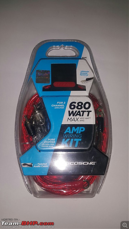

How to identify an original / fake Amp Scoshe wiring kit ?
What gauge should the wire be ?
Original ones say oxygen free copper and have an mrp of 3990/-. The fakes are half that price or lesser.
If you find the original one you don't have to worry about the wire inside. The 8ga kit is available in Bombay for 3k or so.
That's the idea of asking the question .. how to identify the genuineness !
Btw, the one you have shown is a 2 channel kit . is this the one that sells @ 3k~ ?
Yes, its a 2 channel kit but all you need is another rca cable. Mrp is 3990 but I'm getting it for 3k.

That Scosche seems to be CCA (Copper clad alumium) so avoid anyway, even if its original as thats not the best to use. I'm pretty sure my Earthquake Sound kit is also the same and its 8ga hence I want to change to 4ga as my amp is a 800 watts rms.
The others I would not bother with.
