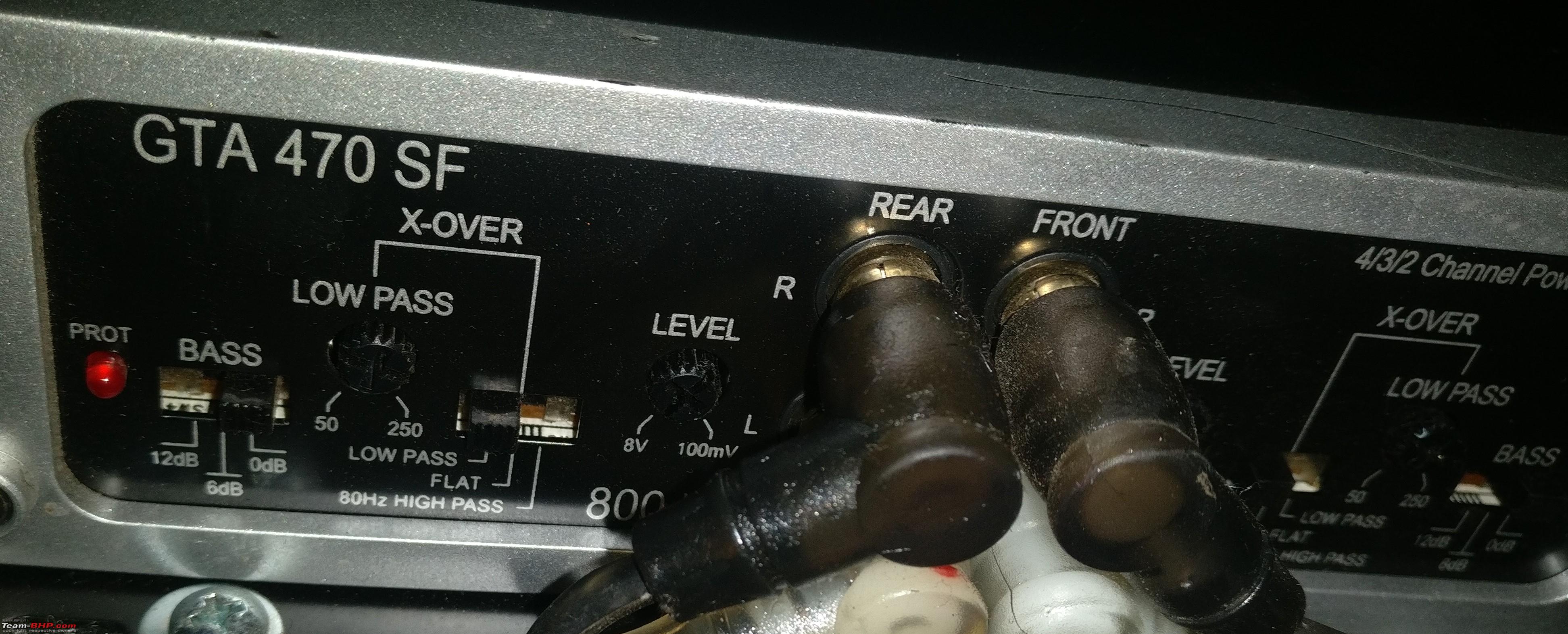

Recently I upgraded RCD310 in my VW Vento 1.6 MPI Highline with Pioneer AVH-Z5190BT. Earlier I had upgraded both front & rear stocks speakers and also added a sub woofer. My current setup is as below -
HU - AVH-Z5190BT
Amplifier - Blaupunkt GTA 470 SF
Front Speakers - Morel Tempo components
Rear Speakers - Morel Maximo (Co-axials)
Sub woofer - Focal (1200 watts) - Enclosed box in trunk
Right now I am playing around for the best tuning. Would like advice on if the current configuration of the system is rightly done or there is any room for improvement. I would like a clear sound with tight bass vs a boomy sound.
Amp settings
Installation in boot
Subwoofer
Bass - 0db
Low Pass - Approx. 90Hz?
How much should be the gain?
Front Speakers
Bass - 0db
High Pass - 80Hz
HU Crossover Settings
Front Speakers
How much should be the ideal slope?
Rear Speakers
Subwoofer

Specification-wise both the systems are capable. For your subwoofer requirement, you will need 3 RCS outs in HU. Both the shortlisted HUs have them. Moreover, both of them have Android Auto which is a big convenience. Time Alignment feature in Pioneer could be a differentiator. You will lose on it if you choose to go with Sony. Of course if you care for that. I have Pioneer AVH-Z5190BT installed in my Vento and I am happy with it. Sound quality is fabulous. I haven't heard Sony though.
Car Audio Advice from the Audio Gurus: Use "Search thread" before posting a new Q!-img_20180718_091409.jpg
Car Audio Advice from the Audio Gurus: Use "Search thread" before posting a new Q!-img_20180718_091404.jpg
Car Audio Advice from the Audio Gurus: Use "Search thread" before posting a new Q!-img_20180718_091506.jpg
Car Audio Advice from the Audio Gurus: Use "Search thread" before posting a new Q!-img_20180718_091415.jpg
Car Audio Advice from the Audio Gurus: Use "Search thread" before posting a new Q!-img_20180718_091553.jpg
Car Audio Advice from the Audio Gurus: Use "Search thread" before posting a new Q!-img_20180718_091606.jpg
