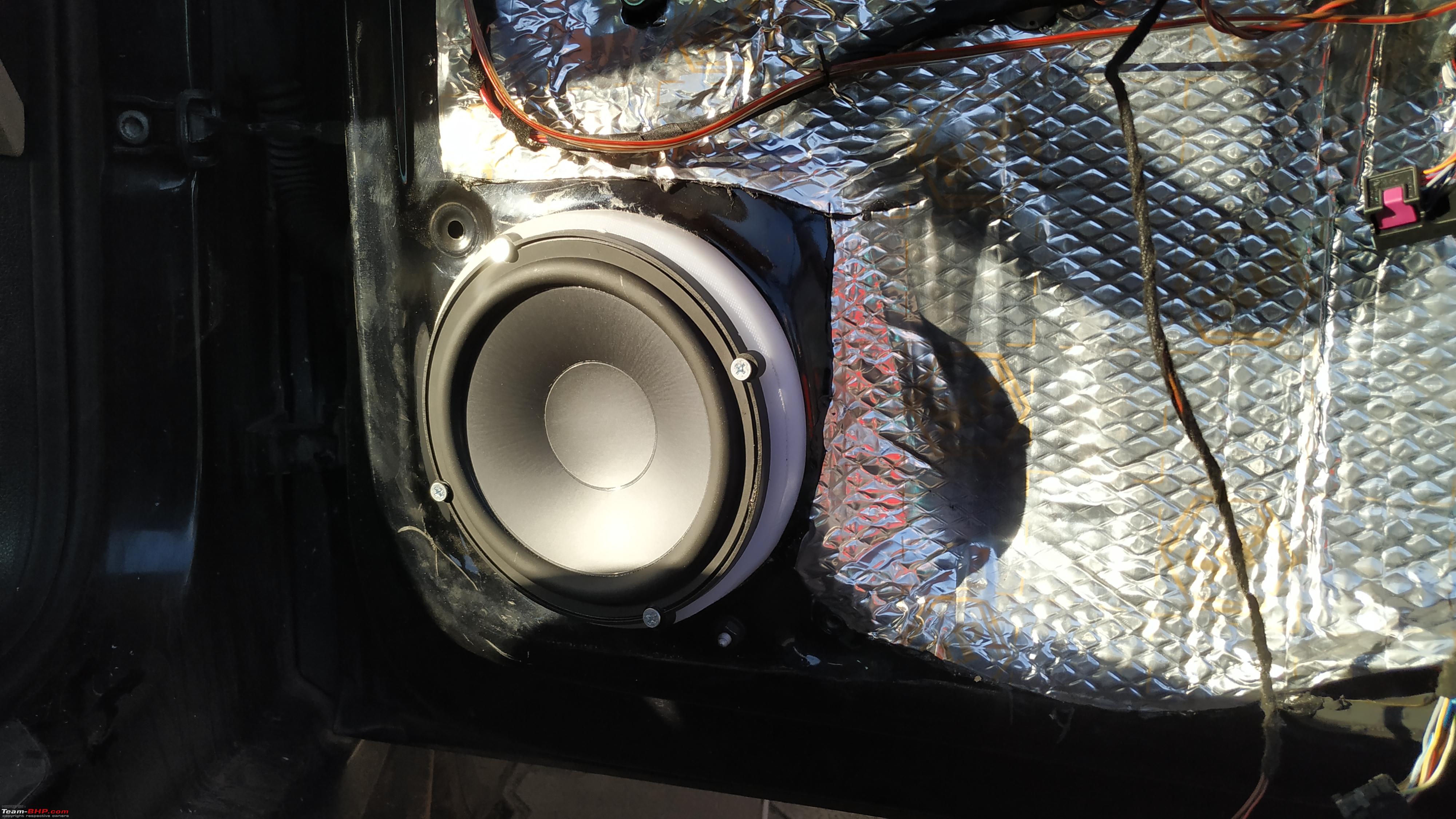

I managed to swap the Focal coaxials on the front door with JBL components. Long story short - the Focal coaxial on the rear left door gave up, so swapped one from the front and put in a pair of JBL components in the front doors.
Since I had to use spacer rings to accommodate the midbass in the front door, I got the spacers fabricated using a 1/2" thick chopping board made of polypropylene material. I was averse to using MDF spacers since I had read about instances wherein the MDF spacers become soggy over time after soaking in water.
Got it cut into rings from a dude who specialises in these switchboard fabrication works. You know the older arrangement which requires a laminated plastic board that holds the switches and sockets.
Car Audio Advice from the Audio Gurus: Use "Search thread" before posting a new Q!-img_20201024_114750.jpg
Car Audio Advice from the Audio Gurus: Use "Search thread" before posting a new Q!-img_20201024_114753.jpg
Car Audio Advice from the Audio Gurus: Use "Search thread" before posting a new Q!-img_20201024_120849.jpg
Car Audio Advice from the Audio Gurus: Use "Search thread" before posting a new Q!-img_20201024_121252.jpg
Car Audio Advice from the Audio Gurus: Use "Search thread" before posting a new Q!-img_20201024_130549.jpg
Car Audio Advice from the Audio Gurus: Use "Search thread" before posting a new Q!-img_20201024_130612.jpg
Car Audio Advice from the Audio Gurus: Use "Search thread" before posting a new Q!-img_20201024_130852.jpg
Car Audio Advice from the Audio Gurus: Use "Search thread" before posting a new Q!-img_20201024_160009.jpg
Car Audio Advice from the Audio Gurus: Use "Search thread" before posting a new Q!-img_20201024_170646.jpg
I was also skeptical about how well would this material be when screwing into the door's sheet metal and while screwing the midbass into it. But the screws were secured perfectly - tight and doesn't keep spinning infinitely!
The local accessories installer whom I'd approached for the work was a bit flummoxed when I handed them the spacer rings. Asked me a lot of details.
