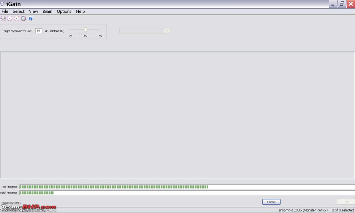

4. Fire up iGain. If your iTunes isn't already open, iGain will ensure that it does. Each time that you start iGain, it will synchronize with your iTunes playlist. This takes a minute or two, depending on the size of your library (60 seconds for my song collection):
