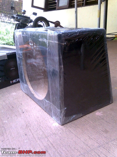

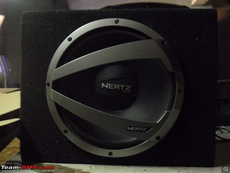

Phase 2
The setup was pretty good enough and it was a joy to increase the volume knob and not hear any jarring. But what I missed the most was the thump. Yes bass, that’s what I wanted badly. The thought of having a Subwoofer thumping inside my car was a dream wanting to come true. Then comes the research on procuring a suitable amplifier and subwoofer.
Basically, I love my music and clarity and SQ is what I look for the most. I wanted the thump but not at the cost of shaking the neighborhood. And most importantly, I wanted to stick to my budget of 20K. Yet again I let myself loose into the ocean of internet and Reo helped me procure the Hertz EP2 amplifier.
Now it was time to decide on the subwoofer. Upon shortlisting I wanted the Rockford Fosgate Prime R1L-1X12 because it came with factory fitted enclosure but sadly there was no stock at the dealers. After weeks of waiting we gave up and decided to hunt for a subwoofer and buy an enclosure separately.
The Hertz EP2 is a 190W RMS amplifier and I was looking for a SVC sub within 250W RMS handling capacity. Finally managed to settle for the Hertz DS300 as it pairs well with the EP2.
In addition to this, I got the amplifier wiring purchased, Soundquest VL series SQK8. Reo sent the stuff by bus and it arrived promptly the next day.
Here are the pictures of the amp, sub, enclosure and wiring.

Thanks dude, the power kit is Soundquest brand and the enclosure is non branded local made but is of very good quality meeting the subwoofer's recommended specifications.
