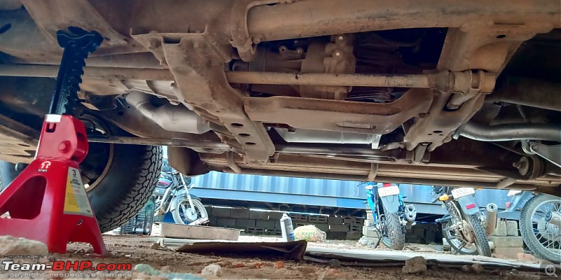

Next up he completed the service on my car and also sent me pictures and messages as and when he found any issue with the car. He was honest & upfront told me that whatever he suggested was not required immediately. Finally he gave the car a clean bill of health. On 29-Apr my Cedia was washed and I picked up the car around 5:30PM. The final bill was very nominal, especially the labour charges. I have driven close to 260kms post service and I must say he has done a great job.
