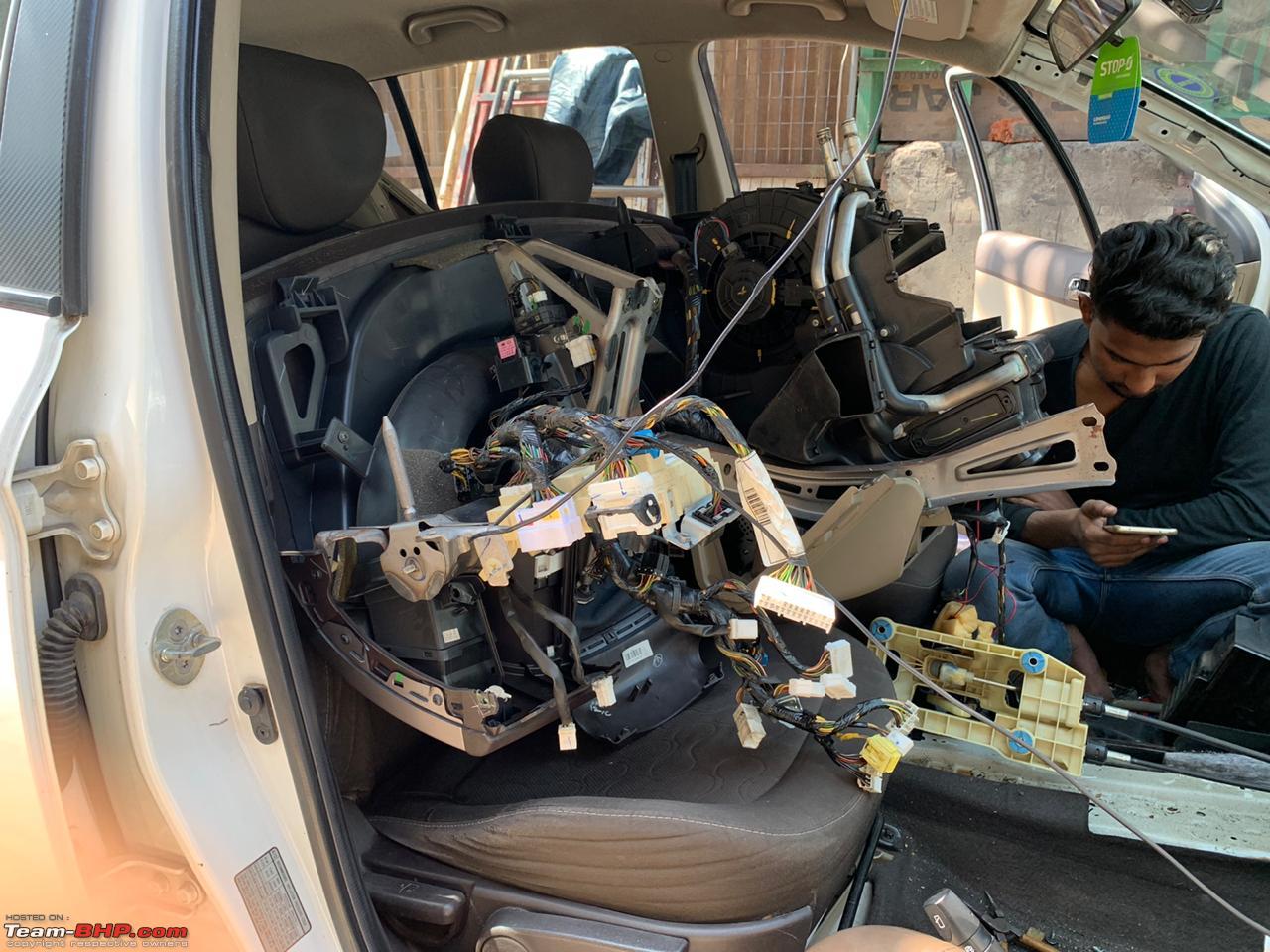

I had a positive experience at Cooldays last weekend.
I went to Manjeet last Sunday to get my AC serviced. My AC had been suffering from gas leakage issues for the past 2-3 years. Every time I got the gas recharged it would last for 6-7 months only. With the impending Delhi summers, I wanted to fix this issue and took my 9 year old i20 (with ACC) to Manjeet.
He is a very nice and polite gentleman. I spoke to him over phone on Saturday evening and fixed an appointment. He hadn't reached the shop when I arrived at around 10:30 (Sunday morning). His boys opened up the hood and checked everything. They suggested a cooling coil replacement. I spoke to Manjeet over phone and he gave me a quote for the replacement. He mentioned that they would need to take the entire dashboard out for this and would take approximately 4 hours to complete the entire job. It would also include an overall servicing with condenser cleaning and gas recharge, et al.
I gave them a go ahead. In about an hour he reached the shop and explained to me a lot of things. The job was done within 3 hours. A summary of the job:
Work done: AC cooling coil replacement and AC servicing
Time taken: 3 hours
Amount paid: INR 5,800
Positives: Manjeet. You have to deal with him and not with his 'boys'. Although it is just my first experience but he seemed like a nice no nonsense guy.
Negatives 1. The place. The working area was particularly dirty and I think it rained the previous day making things worse.
2. His boys. Nothing particular about them; its just that one of them kept telling me how i20 compressors conk off after 55k kms (mine is at 66k) and how I should be prepared to spend another INR 20-25k soon. Maybe they were just doing their job, not sure. Still, I would suggest, deal with Manjeet directly.
EDIT: Manjeet also asked me to keep an eye on the coolant level as this replacement may lead to some depletion.
Finally, the AC is working fine and I am ready for Delhi summers.
Some pictures from the day.

I was actually worried about them putting the entire dashboard back properly. They did a decent job BUT:
1. I found one screw in the backseat of the car. When I showed it to them they were clueless and said they have already fixed a replacement screw in place of the one I found
2. The interiors got very very very dirty. There were finger prints all over the beige plastic parts. So after the job you might have to get an interior detailing done.
He had quoted 1800 for the AC servicing. So 1000 is definitely a good price you got. But then again he had initially quoted 1200 for servicing and I think 1800 was with the cooling coil check (from outside without opening the dash). I have completely mixed up the numbers there.
Overall, including all of this (and Cooling coil) he charged me INR 5,800. When he had initially quoted me the price he had said the price will include the AC servicing as well.
