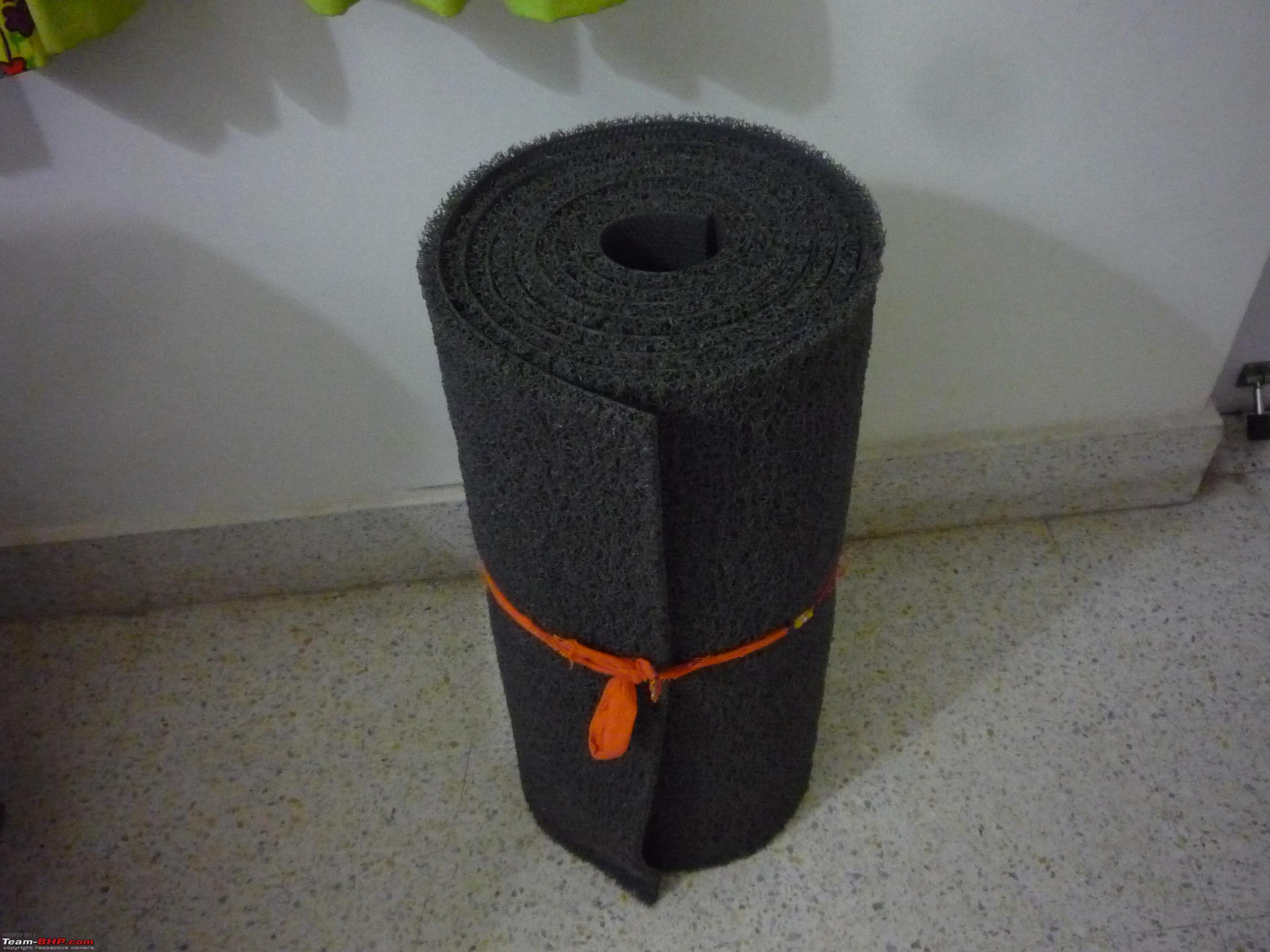

I bought a roll of 12ft. It cost Rs. 1920. I am useless at bargaining. Durosoft is the brand though it isn't written anywhere. I bought grey color. It is very flexible and the loops are soft. I was excited. Got straight to it after dinner and I was done in less than 2 hours. I took it easy and though the template cuts are far from perfect, I feel I got it right for the most part. Some mistakes mostly on the rear cut outs. The section where I got it wrong goes under the front seat so I was not too worried. I ended up using all of the 12ft length. Wasted bits were quite a lot. Better planning on cut out's would have saved some. These mats are heavy. My guess is the cut mats have added a good 20 kilos or a little more.
Before I put in the mats, I soaked them over night with some Nile shampoo. Two reasons; one is to bring down the rubber smell and the other to just rinse them out cause the rolls were standing at a store. The rubber smell has not gone completely. Another wash may be required. The next time around I will dry them in the shade. The water from the rinse was black so that's how much muck or dust was already in the mat.

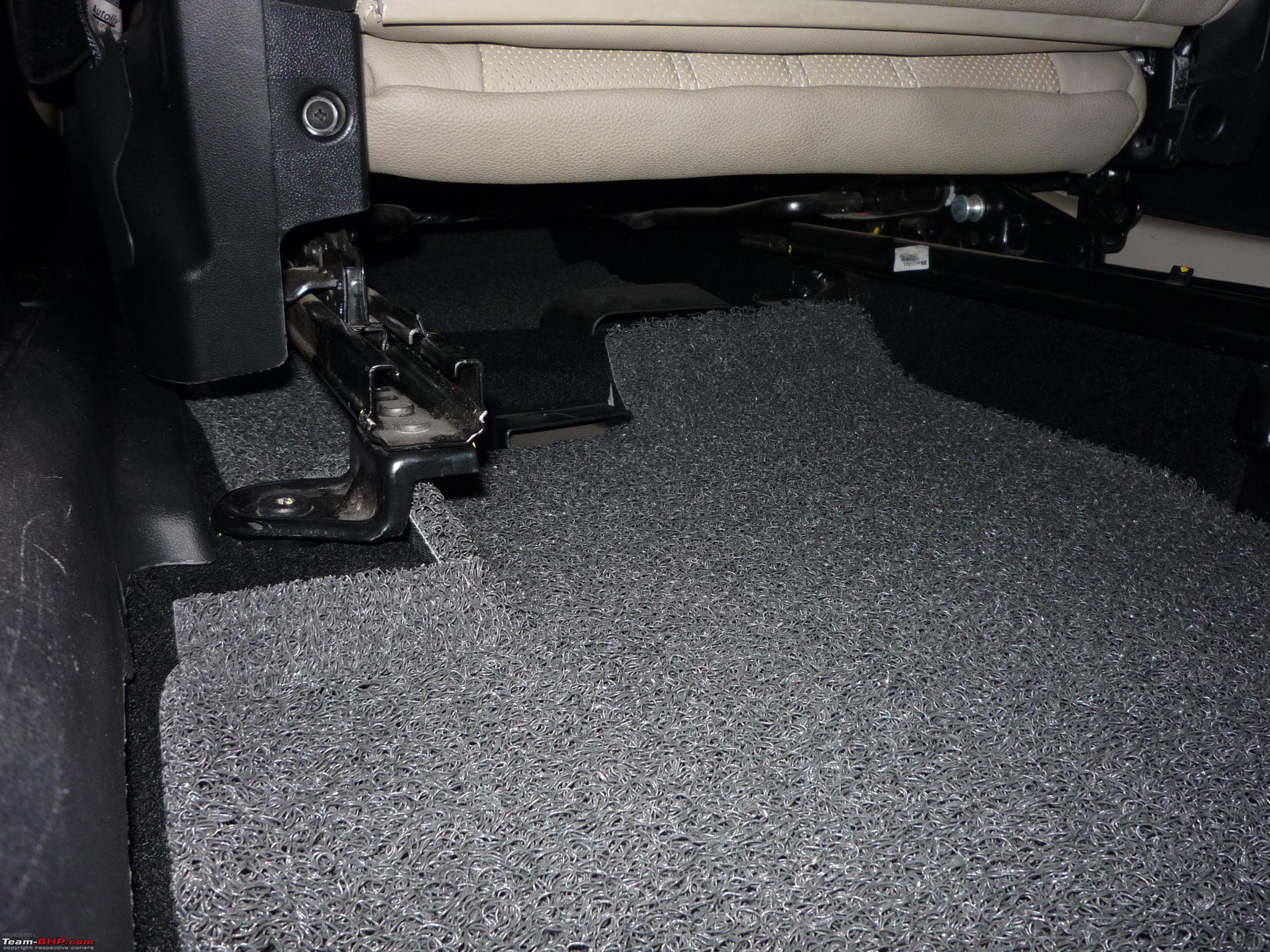

Here are some pictures. Tracing out the insides on a Linea, especially the rear seating area is not easy.
The roll.
A close up of the noodles.

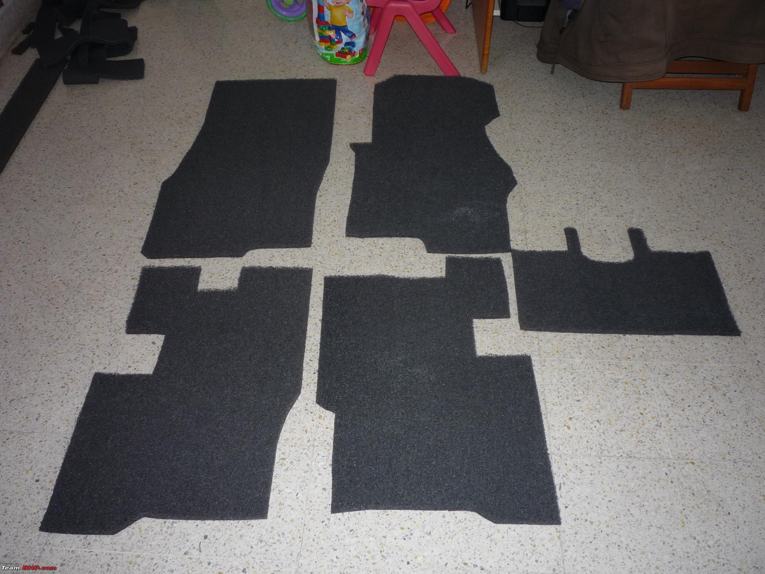

The cuts outs. There are imperfections, especially the lower middle image where I have not cut out a "C" shape for the rear ac foot vent. The vent isn't covered though so I am okay with that.
The under side of the mat has this triangle sort of structure and I am guessing they will be enough to grip the carpet. Let us see. Yet to take out the car out after putting in the new rubber mats.
Quite a lot of wasted bits. Should have been more smart about this.
Drivers seat.
Drivers seat.
Front passenger seat.
Rear section.
DIY - 3M Nomad-Style Floor Mats-p1040315.jpgDIY - 3M Nomad-Style Floor Mats-p1040320.jpgDIY - 3M Nomad-Style Floor Mats-p1040316.jpgDIY - 3M Nomad-Style Floor Mats-p1040317.jpg

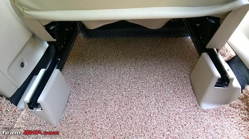

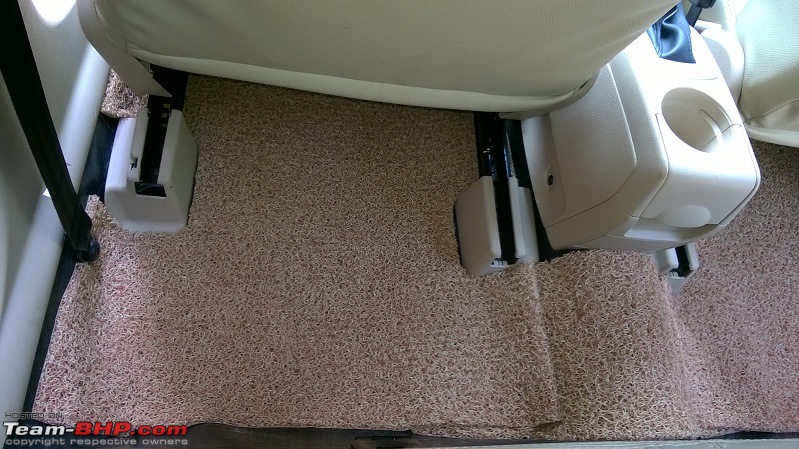

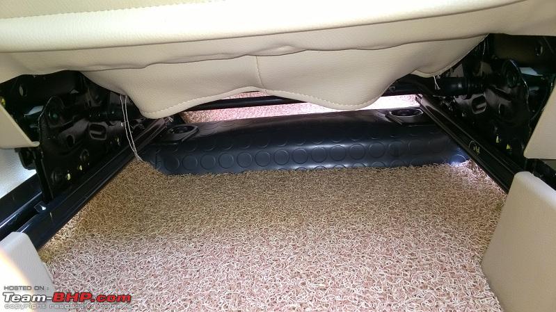

It's been a month and half since I started using noodle mats in my Ford Classic. Decided to post the pics only after using it extensively, so here they are.
Passenger Side
A closer look
Driver Side
Another closer look
Rear floor (Notice the three piece arrangement)
Yet another closer look
Mats extending all the way up to the hump below front seats
Price of the mat used : Rs.1250/metre (the width of the roll was 1.2 m)
Quantity purchased : 1.4 m (1.4 x 1.2 = 1.68 sq.m)
Total Expenditure : Rs.1750
While cutting out the patterns, I totally neglected the OE mats and solely depended on newspaper templates and hence wastage was minimal and there were enough extra portions on every mat so that they could be easily slid beneath the sides of each area. This in turn prevented any sort of sliding and the vinyl flooring beneath the mats remained completely dust free even after 1.5 months of usage.
And here comes the best part, trust me or not the above pics were clicked just before I took out the mats for the first ever cleaning after 1.5 months of heavy usage and you won't believe the amount of dirt the damn thing was holding. All the loose dirt, mud, small stones etc. were just falling off the mats when I started to shake it and the way these mats concealed all this dirt really deserves some appreciation. Time for the pros and cons.
Pros
1. Really heavy duty and conceal all sorts of dirt for a considerable period of time
2. Very very easy to clean. Take it out, bang it against a wall and you're done.
3. Fits like a glove. If the templates are cut out perfectly, it leaves no room for the dirt to penetrate and no sliding from the actual position.
4. Lighter shades really gives an airy and luxury feel to the interior. Every single person who stepped into my car gave a good comment about the flooring.
5. Durable. Yes 1.5 months is a pretty short span to redeem a stuff as durable, but by the looks of it I really got a feeling that this thing is gonna last long. (Really long)
Cons
1. Somewhat pricey, but hey, this is one of the best examples of money (and time) well spent on a car and trust me, your mom or wife are not gonna complain about it.
2. I've heard users complaining about the rubbery smell lingering around for a while but I didn't face such an issue.
PS : IMO it is better to go for lighter shades like beige than darker ones like black, maroon etc. as the latter shows the dirt easily.
Finally, to all fellow BHPians who still have not tried this :
'GET NOODLED, STAY HAPPY!'
