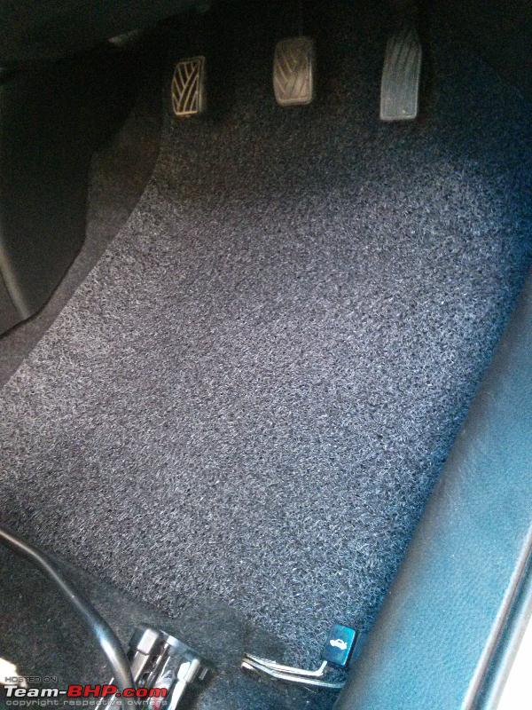

Thanks to this thread and bhpians: Dinu, kiranvakati, rajoy, gannu_1 & kash_pegasus for the visuals and the inspiration. Drove down to Thippasandra and picked up the noodle mats from Handloom house (not an easy place to locate!). Searched for the same in Whitefield and Malleswaram but none of the stores had these in stock.
Got 2ft x 8ft (black color)for my Wagon R, which came up to 1,200. Think this is slightly on the higher side as I remember someone posting that they paid Rs 65 per sqft. Drove back home and spent an hour cutting and shaping the mat.
Viola! Now my 4 year old ride sports trendy black non slip floor mats clap:
Haven't had a chance to look at the 3M Nomad mats but I feel that these could have been a little thicker (2-5 mm). Current thickness is about 11-12mm from the base to the top of the noodles.
