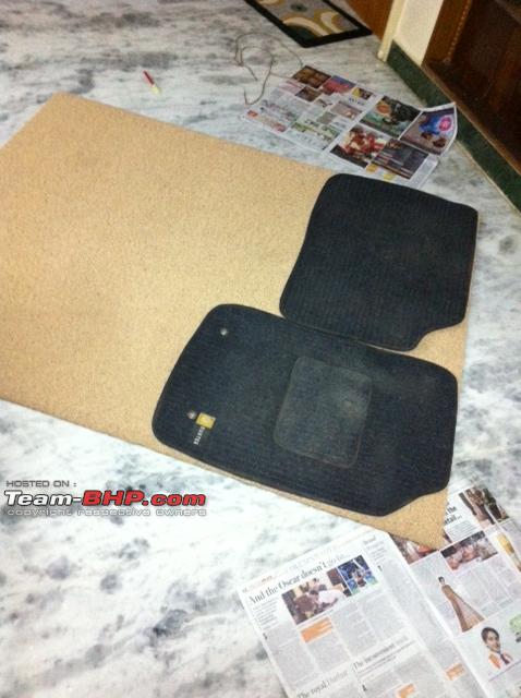

Me and bhpian roy-libran got 80 sqft of ULTIMAT at 50inr per sqft from Laxmi Nagar Delhi. I needed 20 sqft for my Punto while the rest is for Roy's Gurkha.
The project is complete and I must say I am very happy with the outcome.
I goofed up big time by not actually reversing the original mats while creating the outline on the new sheet. I had it in mind but it slipped my mind, during project execution. However the result was not too bad. I used a normal domestic scissor, the 10 inches one with plastic grips, to cut the sheet!
The only little drawback: the odor, you just can't miss the plasticky-rubbery smell, immediately after you get in the car. I used some "essential oil" from Khadi, a few drops on a silica gel sachet (as the retainer) and put in a cubbyhole. The raw smell is gone and I get just a faint rosy fragrance.
