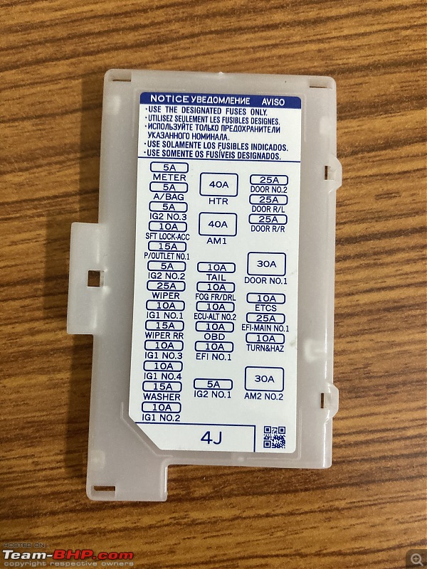

I’m trying to hardwire my dashcam in my Innova Crysta 2021. Lost trying to locate the fuse box that I need to connect to. Can someone guide please?
Check if it is under the steering wheel panel or behind the glove box. Also, refer to the Owner's manual, it will have the details of the fuse box location.
Following your guidance, I found this under the glove box:
DIY Install & Review - The Mini 0806 Dash Camera-78247cf4a04242ff9668db75584ca209.jpeg
It has this cover, that I took off to be able to read it clearly:
DIY Install & Review - The Mini 0806 Dash Camera-31a00f780ca8436696518509ff897802.jpeg
I hope I reached the right place.
Thanks to the help. I shall search this thread to find out which fuses I need to tap into.

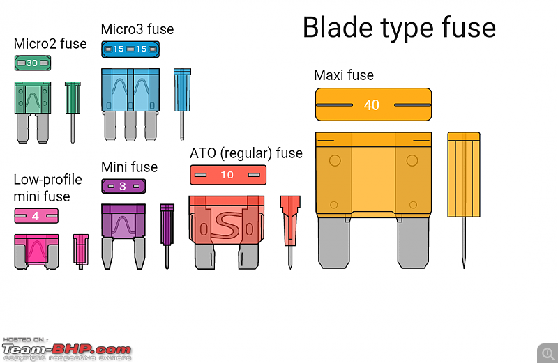

There must be a fuse puller in the engine compartment fuse box. Use that and pull out one fuse example: "P/Outlet No.1"* and hardwire the dashcam to that fuse. Can you post the picture of the fuse after pulling one of them out?
DIY Install & Review - The Mini 0806 Dash Camera-screenshot_20161002113830.png
See which type fuse matches the one in your car from the above diagram and order that specific spare fuse and fuse tap cable for easy hardwiring.
*Note 1: Ignition should be OFF during this time for safety purpose.
Note 2: Avoid using critical fuses like A/BAG, ETCS etc reason, for any reason the fuse blocks, car safety will not be compromised.

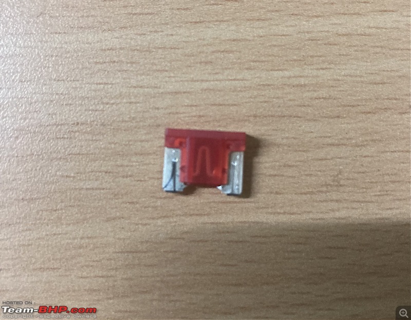

Here we go:
DIY Install & Review - The Mini 0806 Dash Camera-efc8bb63ba854a9c94c22216a8b9347f.jpeg

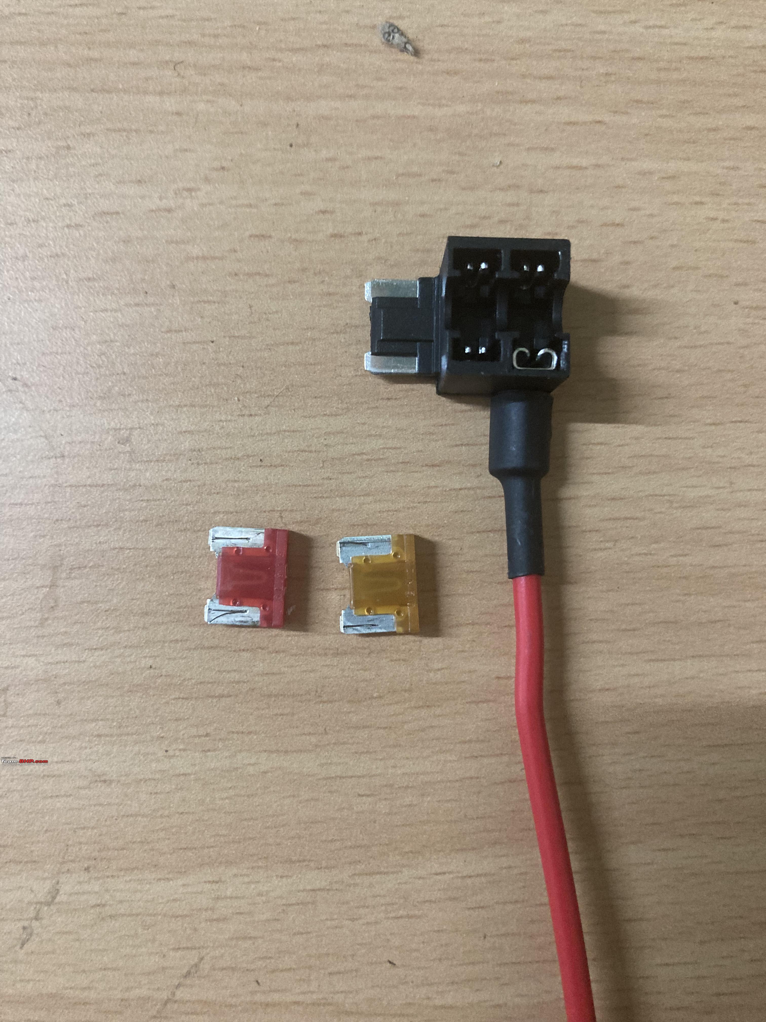

I have the correct fuse taps
DIY Install & Review - The Mini 0806 Dash Camera-f3215e511c664cb68ef4217431b2366c.jpeg

Thanks a ton for the detailed and step by step instructions. I managed to install it albeit with some challenges. :D
Originally Posted by a4anurag (Post 5063473)
You can use:
P/Outlet No.1
Fog FR/DRL
I ended up using Hazard Lt/ Indicator for VCC and Fog Lt/ DRL for ACC.
Unfortunately the micro SD card that had lying around was incompatible. So I could not check the functioning of the dashcam. Waiting for a card to be delivered from NexDigitron. Will update once I plug in the card.
The cable for the rear cam was not long enough for routing through the floor of the car. I had to move the cable along the ceiling but I am quite confident that it’s not coming in the way of the curtain airbags.
I ended up losing two of the Trim Panel Retainer Clips on the A pillar panel and the panel near the passenger foot. I have managed to keep them in place using double side tape, and will have to fix it in my next workshop visit.
In the rear too, I pulled out the rubber wire harness to snake the rear cam cable through it, but could not push it back to fit snugly into its slot. That’s also something that I’ll have to leave for the workshop.
But at the end of it, it was a day well spent, and a job done quite well. Thanks to a4anurag clap:
