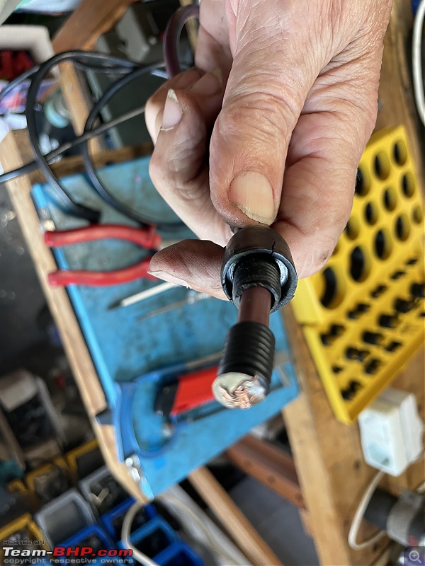

I use J&B weld to fix the CCV, next morning I took the Jeep for a test drive. The good news, no oil leaks from the rear crankshaft seal, the crankcase or the valve cover!! Also, the piston slap is a whole lot less!!
The bad news: the engine hesitates now and then above 60-70 km/h and the CCV snapped again. I need to fix that because it does draw in false air. It also has a very faint whine
So I decided to put a little pipe inside it.
My Car Hobby: Jaguar XJR, Mercedes W123, Alfa Romeo Spider, Jeep Cherokee & Mini One-img_2979.jpeg
I put the Jeep back in my garage and listened to the engine with my stethoscope to see if I could find anything out of the ordinary. I found that the injectors on cilinder 5 and 6 were barely, if at all, ticking during idle. I pulled the plugs and they were a bit corroded, cleaned them and put them back and it sounds better now.
I will need to figure out how to put the CCV back into the valve cover. The grommet has become very very hard. I will try my trick by putting it in boiling water. If the worst comes, I will have to replace it.

After our customary coffee, we started working, once again, on the Austin Somerset. For some reason, we had lost the spark once again.
I double check the new capacitor and also measured all spark plug leads and coil leads. The coil is an original Lucas and has a very wonky electrical connection at best. It is almost impossible to think this electrical connection held out all those years.
The end of the wire is stripped and then folded around a little metal O-ring. There is a plastic coupling that is supposed to press it against a metal screw. It is wonky at the best of times. Also, the plastic coupling had broken off. So it wasn't pushing the wire/O-ring securely against the screw deep inside the coil.
My Car Hobby: Jaguar XJR, Mercedes W123, Alfa Romeo Spider, Jeep Cherokee & Mini One-img_3009.jpeg
We experimented a bit with various improvised solutions:
My Car Hobby: Jaguar XJR, Mercedes W123, Alfa Romeo Spider, Jeep Cherokee & Mini One-img_3010.jpeg
This is our mkIII version and it worked reasonably well. We cut off the coupling, so it was straight again and added multiple small rubber O-rings on the wire. Now when tightening the coupling it would push the wire with its wire/o-ring firmly against the screw inside the coil.
My Car Hobby: Jaguar XJR, Mercedes W123, Alfa Romeo Spider, Jeep Cherokee & Mini One-img_3012.jpeg
