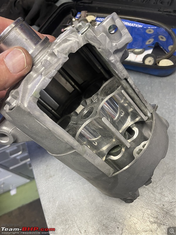

Back in my shop, I took off the insulation tape and all the paper and kit I had used to protect the inside of the compressor. A lot of beads came out too, look at how tiny these beads are.
My Car Hobby: Jaguar XJR, Mercedes W123, Alfa Romeo Spider, Jeep Cherokee & Mini One-img_4769.jpeg
Next, I took the housing apart again and started painting. It is common on these cut-away models to paint the actual cuts (i.e. where you cut or milled through) bright red.
My Car Hobby: Jaguar XJR, Mercedes W123, Alfa Romeo Spider, Jeep Cherokee & Mini One-img_4773.jpeg

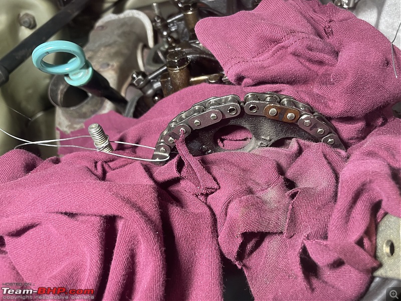

Next back to the Mercedes W123. As I mentioned earlier, after much debate, discussion and head-scratching the only conclusion was that the distribution chain is one tooth off. So the camshaft is trailing 18 degrees behind the crank, at dead centre position.
So we made several different markings on the chain and the gear wheel.
My Car Hobby: Jaguar XJR, Mercedes W123, Alfa Romeo Spider, Jeep Cherokee & Mini One-img_4872.jpeg
Next, I grounded off, two of the protruding ends of one shackle.
Very carefully, we don't want to damage anything
My Car Hobby: Jaguar XJR, Mercedes W123, Alfa Romeo Spider, Jeep Cherokee & Mini One-img_4874.jpeg
Peter is in full safety gear. Grinding is hard on the eyes and lungs!!
My Car Hobby: Jaguar XJR, Mercedes W123, Alfa Romeo Spider, Jeep Cherokee & Mini One-img_4873.jpeg
Notice how we had used metal wires to tie both ends of the chain to the top of the engine. You don't want to chain dropping inside the engine. Lots of rages to prevent dirt, filings and tools from dropping into the inside of the engine.
More grinding is done.
My Car Hobby: Jaguar XJR, Mercedes W123, Alfa Romeo Spider, Jeep Cherokee & Mini One-img_4875.jpeg
Done, I could pop the little connector plate of the shackle.
My Car Hobby: Jaguar XJR, Mercedes W123, Alfa Romeo Spider, Jeep Cherokee & Mini One-img_4876.jpeg
Both Peter and I lifted the respective ends of the chain out of the sprocket. We carefully rotated the camshaft one tooth and put the chain back onto the sprocket wheel. Pushed a new locking plate onto it. This was the biggest challenge, it must have taken us about an hour to get this damn little thing in place.
My Car Hobby: Jaguar XJR, Mercedes W123, Alfa Romeo Spider, Jeep Cherokee & Mini One-img_4877.jpeg
With it finally in place, I used my special chain punch to secure the new shackle.
My Car Hobby: Jaguar XJR, Mercedes W123, Alfa Romeo Spider, Jeep Cherokee & Mini One-img_4878.jpeg
I finished by tapping the two tiny eendbitswith a punch and a hammer. Finally, I checked the diameter. Our improvised riveting technique had ensured that the little protruding pin, now flattened was about 0,2mm larger than the pin diameter itself. More than sufficient.
I gave a couple of full turns on the crank to ensure none of the valves was hitting a piston. Better safe than sorry.
Next, Re-installed the chain tensioner, the dynamo, spark plugs, spark leads, air inlet filter and all the other bits and pieces.
My Car Hobby: Jaguar XJR, Mercedes W123, Alfa Romeo Spider, Jeep Cherokee & Mini One-img_4893.jpeg
The Mercedes fired up right away and I took it for a test drive. I have not been on the motorway yet, but I am very happy to report the "stuttering" is finally gone. The engine runs very smoothly, with much better pick-up and acceleration too.
I used my scope to quickly check the ignition timing. I think it is a bit off. I will call Cor, my friendly W123 specialist and arrange to visit him. Ican'tt adjust the CO myself. I don't have a CO analyser. Very expensive bit of kit. When you adjust the CO levels, you also adjust idle and pre-ignition all at the same time.

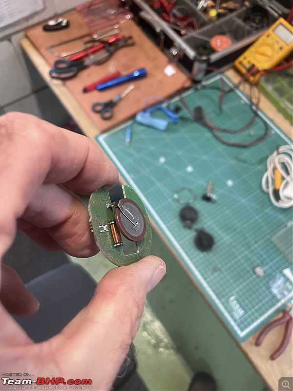

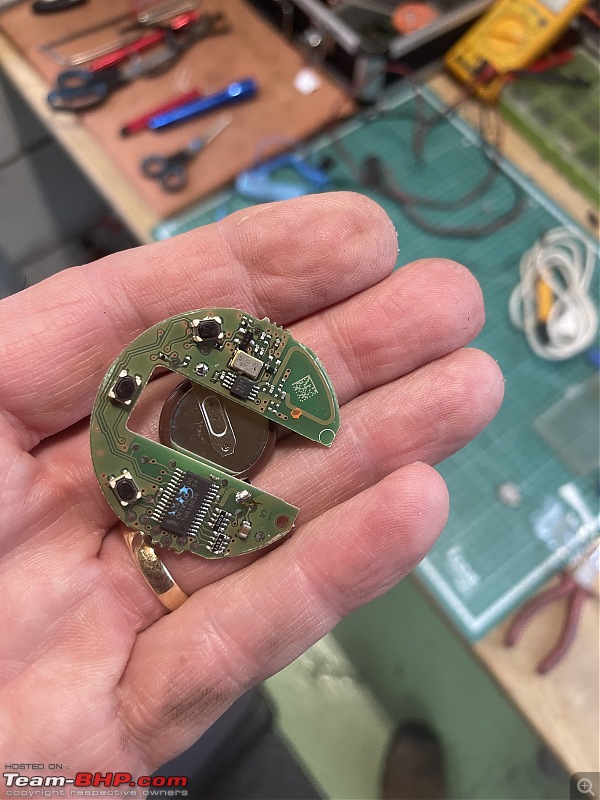

My Mini does not have the comfort package. This means the key FOB is sealed and BMW/Mini doesn't want you to change the battery yourself. Well, you can imagine what a new BMW/Mini key FOB is likely to cost. Probably more than I paid for the whole car.
So I decided to take it apart. We have a few, recent, threads on battery replacement on Key FOBs, so I thought I would show the various steps involved.

Let's take a closer look at the Key FOB circuit board. It is very simple. All Key FOBs look similar. You can see the three little micro-switches. These do wear out over time and can often be replaced individually as well. I just sprayed some electro cleaner on them
My Car Hobby: Jaguar XJR, Mercedes W123, Alfa Romeo Spider, Jeep Cherokee & Mini One-img_5005.jpeg
The rear of the little circuit board. Note the coil. That is part of the induction system to provide electrical charge to the battery without having external contacts.
