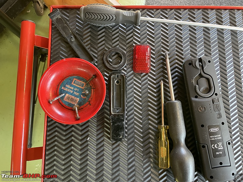

Various brake jobs on the Fiesta!
Mrs. D Fiesta will need an annual service and an APK (Dutch MOT equivalent). As this Fiesta turns 10 years, its distribution belt must be replaced. I discussed it extensively with spanner mate Peter. In the end, we decided to let the Ford Garage handle it. Even though Peter and I must have replaced at least several dozen distribution belts and chains on all kinds of cars over the years.
The Fiesta requires five special tools that I would need to buy. More importantly, it would most likely take us at least 3-4 days, we don't have a lift, and we would have a very worried Mrs. D looking over our shoulders and driving one of my cars all that time. We have an excellent marriage, but I'm not sure if we could handle that sort of stress and anxiety.
So I made the appointment with Ford for the service and APK in two weeks. Last time we noticed that the front discs were getting a bit thin. I decided to check before taking the Fiesta to Ford. Replacing front discs is a straightforward job. And it will save an awful lot of money. So with Mrs. D out for the day, I started.
My Car Hobby: Jaguar XJR, Mercedes W123, Alfa Romeo Spider, Jeep Cherokee & Mini One-img_0545.jpg
As per the usual, rear wheel choked, and front up on the jacks and axle stands.
My Car Hobby: Jaguar XJR, Mercedes W123, Alfa Romeo Spider, Jeep Cherokee & Mini One-img_0506.jpg
I have this set of special "disc-calipers". As the discs wear, a ridge will form around the circumference of the disc. You need this special tool to measure properly.
My Car Hobby: Jaguar XJR, Mercedes W123, Alfa Romeo Spider, Jeep Cherokee & Mini One-img_0507.jpg
The disc was only about 0,1mm above the minimum thickness
My Car Hobby: Jaguar XJR, Mercedes W123, Alfa Romeo Spider, Jeep Cherokee & Mini One-img_0509.jpg
For good measure I also checked the drum brakes at the rear. Front wheel choked, jack, axle stand etc.
Remove the wheel and next remove those two little torx-bolt holding the drum. Next pry of the drum. It is good practice to clean the whole area of brake dust before starting this little job.
My Car Hobby: Jaguar XJR, Mercedes W123, Alfa Romeo Spider, Jeep Cherokee & Mini One-img_0510.jpg
Removing a brake drum can be a bit of a challenge. Especially if the drum is worn, the shoes might get stuck behind that inside ridge. In which case, you need to adjust the shoes and turn them in. These drums might also get very stuck. Look closely, the drum has a single threaded hole, thread a bolt in there and it will push the drum outwards! Drum removed
My Car Hobby: Jaguar XJR, Mercedes W123, Alfa Romeo Spider, Jeep Cherokee & Mini One-img_0512.jpg
I measured the thickness of the brake shoes and the internal diameter of the drum. All well within specification. Before re-assembly, give everything a good cleaning.
My Car Hobby: Jaguar XJR, Mercedes W123, Alfa Romeo Spider, Jeep Cherokee & Mini One-img_0516.jpg

To get access to this inside of the door, the doorcard has to come off. You will have seen me do this countless times on the Spider and some of my other cars too. Out comes my nifty tool!
My Car Hobby: Jaguar XJR, Mercedes W123, Alfa Romeo Spider, Jeep Cherokee & Mini One-img_0726.jpg
This is what the doorcard looks like on the inside. It has some mold on it and some of the holes that hold the plastic trim bits are torn. I have already spoken to my good friend Bianca. She had redone the doorcards on her Spider recently. She has a piece of the correct wood left and she will help me make a new door card sometime in the next couple of weeks. She is much better at this sort of work than I am. For now I will put this old crappy one back at the end of this job.
My Car Hobby: Jaguar XJR, Mercedes W123, Alfa Romeo Spider, Jeep Cherokee & Mini One-img_0727.jpg
inside of the door with the doorcard removed;
My Car Hobby: Jaguar XJR, Mercedes W123, Alfa Romeo Spider, Jeep Cherokee & Mini One-img_0731.jpg
You only need to take a few screws and bits of the door to remove the doorcard. Knowing where all these screws are is the tricky bit. Some are pretty much hidden from plain view.

The other day I noticed condensation in one of the Mini lights.
These are the fog/DRL lights. However, my Mini does not have the Front Fog light option. As you will see, that was most likely the cause of the water ingress/condensation.
My Car Hobby: Jaguar XJR, Mercedes W123, Alfa Romeo Spider, Jeep Cherokee & Mini One-img_0796.jpg
On the Mini, you get access to the lights via the wheel well arch. There are two little inspection covers inside the liner you can take out, just to replace the bulbs. If you need to take the complete light unit out, the wheel arch liner has to come out.
So, on the jack and axle stand, the wheel comes off.
My Car Hobby: Jaguar XJR, Mercedes W123, Alfa Romeo Spider, Jeep Cherokee & Mini One-img_0797.jpg
Here you see those two inspection/light bulb change-out covers.
My Car Hobby: Jaguar XJR, Mercedes W123, Alfa Romeo Spider, Jeep Cherokee & Mini One-img_0798.jpg
I undid the fasteners and peeled back the wheel well liner. I left the rare section in place.
My Car Hobby: Jaguar XJR, Mercedes W123, Alfa Romeo Spider, Jeep Cherokee & Mini One-img_0799.jpg
The window spray reservoir has to come out too. Three bolts, two connectors and one small hose disconnected. The reservoir has a very odd shape. In the middle it is open, to accommodate access to this very Foglight/DRL to change out the bulbs. The filler neck has some very elaborate twists in it, and poke through various chassis struts up next to the air filter. Apart from the three bolts it is held in place at the bottom with a large plastic bracket. Which I broke pulling the reservoir out of course.
My Car Hobby: Jaguar XJR, Mercedes W123, Alfa Romeo Spider, Jeep Cherokee & Mini One-img_0800.jpg
My Car Hobby: Jaguar XJR, Mercedes W123, Alfa Romeo Spider, Jeep Cherokee & Mini One-img_0801.jpg
The offending part is finally out!
My Car Hobby: Jaguar XJR, Mercedes W123, Alfa Romeo Spider, Jeep Cherokee & Mini One-img_0802.jpg
Here you can see the problem. The DRL fitting goes into the small top opening and seals that. But as my Mini does not have a front fog light, the main much larger opening has just been "taped shut" by the Mini-geniuses! At some point in time that will start to peel back and you will find water inside the light unit of course! Duh!!
My Car Hobby: Jaguar XJR, Mercedes W123, Alfa Romeo Spider, Jeep Cherokee & Mini One-img_0803.jpg
My Car Hobby: Jaguar XJR, Mercedes W123, Alfa Romeo Spider, Jeep Cherokee & Mini One-img_0804.jpg
I used a kitchen towel to dry out the inside as much as possible. Next I put it on the window shelf of our kitchen, in the sun to dry out completely.
