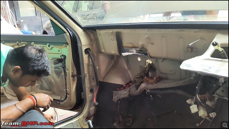

Ironically, in my case it was in my 800. The car which is pampered the most in my house. Reason was, due to its sealed box section, rats had accumulated crap inside, which got stuck against the fresh air wall on one side, and that retained moisture for extended period. It completely rusted after 16 years of ownership. Thankfully it was just the wall and not the cowl itself.
Almost all workshops recommended replacing the cowl, but thankfully my MASS wasn't in favour of doing such a major work, which can damage the chassis dimensions too if not done properly. Rather they just removed the damaged part, made a similar shape using sheet metal, and welded it back. Easier said than done. Rust proofing later on was done completely using Zinc spray, epoxy primer etc.
When the car was in workshop, I also got all box sections washed, dried and coated. I was monitoring the steps with endoscope camera, which gave me eyes on hidden places ( the reason why this entire episode happened)
DIY: City cowl panel cleaning & the subterfuge of Honda service centers-rusted.jpg
DIY: City cowl panel cleaning & the subterfuge of Honda service centers-how-normal-cars.jpg
DIY: City cowl panel cleaning & the subterfuge of Honda service centers-ouch-moment.jpg
DIY: City cowl panel cleaning & the subterfuge of Honda service centers-cut.jpg
DIY: City cowl panel cleaning & the subterfuge of Honda service centers-fabrication.jpg
DIY: City cowl panel cleaning & the subterfuge of Honda service centers-treated.jpg
More details here: http://www.team-bhp.com/forum/long-t...ml#post4107602
