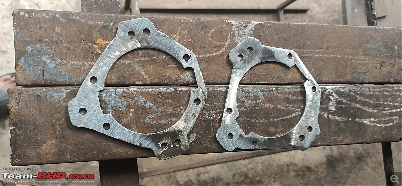

Took out the stock fog lamp and brackets only to realize that stock brackets cannot be used for new projectors. I contacted FE Retrofit on their FB page for sending me required brackets.
There was no response from them.
Please note that the stock brackets have a peculiar design and most of the readily available brackets may not fit here.
The next option was to fabricate custom brackets for which I went ahead and fabricated stainless steel brackets from a local fabricator.
He did a good job and the projector was mounted on to custom bracket with 4 screws.
The brackets were fitting perfectly on the bumper too.
Post that installed the bulbs on projector and completed the wiring. Fitted the ballast on to bumper with nuts and bolts so that it does not move.
Small Power adapters were glued using 3M tape.
Custom SS Brackets

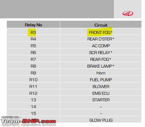

After going through Thar Manual, I understood that Thar comes with a separate relay for foglamp.
The fuse for fog lamp is rated for 10A. So I am assuming fog lamp wiring can handle load up to 120 Watt (Ohm's law P = W X I, 10A X 12V = 120W). Experts can correct me if I am wrong.
Manual
DIY: FE Retrofit projector foglamps on my Mahindra Thar (2nd-gen)-manual.jpg
Hence purchased purchased the sockets needed to connect Ballast to Stock foglamp and plugged it and there was light

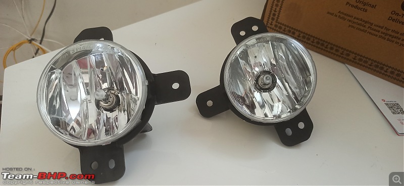

I was looking at the foglamps you got vs the stock ones and realized that fabricating those brackets would have required a lot of thought; perfectly done.
Created a collage of both in one frame - and I don't think there was any way that the new ones could have been fitted on even two of those "ears" .
Would you have a picture of how the stock fogs' fitment was when you removed the bumper?

Thank you Vigsom.
Please find the pics of stock brackets and stock fog lamps.
I have removed the adjuster clip.
DIY: FE Retrofit projector foglamps on my Mahindra Thar (2nd-gen)-img_20210501_111228.jpg
DIY: FE Retrofit projector foglamps on my Mahindra Thar (2nd-gen)-img_20210501_111141.jpg
DIY: FE Retrofit projector foglamps on my Mahindra Thar (2nd-gen)-img_20210501_110953.jpg

Originally Posted by MithunSathianat View Post
As this is a bi-xenon projector, solenoid wires were available to activate high beam. This needs to be connected to high beam of headlights so that fog lamp high works in sync with headlight high.
There is already a relay for headlights with ceramic holders. As it may cause excessive heat, I have connected it to high beam of spare stock H4 holder which is unused after installing relay.
Nice job!
D2H selection is excellent for the best output. I also liked the way you planned and did the custom SS bracket fabrication works. They will be durable in rough conditions as well.
If possible, could you please share more detailed information about the relay, high beam wiring, and connectors with a rough network diagram.

Originally Posted by g_shyam View Post
A Very detailed DIY!. I am replacing my fog lamps with LED ones and am facing the same problem with the brackets. can you please share the contact details of the fabricator. I am in Thrissur right now and the people I have contacted nearby don't seem to be very confident the job properly.
I got it done from a small fabrication shop near by my place (Kakkanad).
I have taken the stock brackets and projectors to the person and explained my requirements.
Even though he did not have any previous experience, he did what was instructed.
Any good fabricator near your place should be able to do the job easily after seeing your lights and stock brackets.
