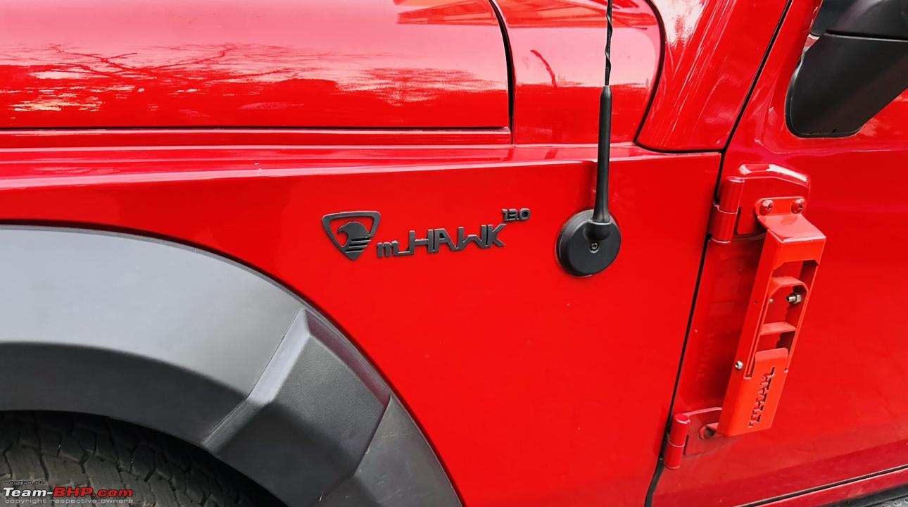

I really wanted to get the chrome (EYESORE) delete done as soon as possible, but all workshops near me gave outlandish quotes in the ~Rs.4000 range!
DIY: Badge De-Chrome with black rubber paint (Mahindra Thar)-3.png
I decided to go the DIY route, and picked up a can of Rust-Oleum Automotive Peel Coat Spray Paint from Amazon for Rs. 650
Sunday morning 11am I readied my DIY basket to dechrome the car myself, and got to it! DIY Basket contents:
Ø 3M Glass Cleaner (Used to clean the emblems, since it has IPA)
Ø Tooth Brush
Ø Cotton Swabs
Ø Microfiber Cloth
Ø Masking tape
Ø Cello Tape
Ø Paper (For masking)
Ø Rust-Oleum Automotive Peel Coat Spray Paint (Matte Black)
Ø Toothpick to aid in peeling
Step 1: Clean the emblem
DIY: Badge De-Chrome with black rubber paint (Mahindra Thar)-4.png
Liberally sprayed the cleaner on the emblems, and gave it a nice rinse and wipe with the microfiber towel. Then proceeded to get into the nook & crannies using a damp cotton swap. Trust me, your car emblems are much dirtier than they look!
Step 2: Masking (Most important step)
DIY: Badge De-Chrome with black rubber paint (Mahindra Thar)-5.png
I wasn’t too worried about overspray here, since this is rubberised paint, overspray just peels off the car. Nonetheless, I wanted to make sure I keep it to a minimum, to please the inner OCD.
First I masked off the emblem with just tape on all 4 sides, leaving 1-2 inches of space. Leaving this space is crucial to ensure a clean peal of the paint, or else you’ll be struggling to get small pieces of rubber out from between the emblem gaps.
DIY: Badge De-Chrome with black rubber paint (Mahindra Thar)-6.png
DIY: Badge De-Chrome with black rubber paint (Mahindra Thar)-7.png
DIY: Badge De-Chrome with black rubber paint (Mahindra Thar)-8.png
Step 3: Spray Spray Spray!
I gave each emblem a total of 5 coats each, with each coat getting progressively heavier.
The first coat was extremely light, mostly for giving me a sense of how rubber paint sprays out (and trust me, it’s different from your regular spray paint). Each progressive coat was sprayed only after the previous coat was completely dry.
Also made sure to spray for all angles, since the emblems are 3D & quite thick on the Thar, to ensure no chrome spots were left uncovered.
DIY: Badge De-Chrome with black rubber paint (Mahindra Thar)-9.jpeg
Step 4: Peel Peel Peel!
Here it comes, the most satisfying part of this DIY, peeling off the rubber paint, and oh boy was it a lot of fun! My wife joined in for this part too!
Got to be careful while peeling, ensuring you don’t peel off the rubber on the emblem too! The mighty toothpick was my best friend here, making a fast job out of the nook and cranny peel.
DIY: Badge De-Chrome with black rubber paint (Mahindra Thar)-10.png
Gave the emblems a good wipe after the peel, took a few steps back, and enjoyed the fruit of my effort!
And now, it’s time for you to enjoy the fruit, for reading through this post! Enjoy!
DIY: Badge De-Chrome with black rubber paint (Mahindra Thar)-11.jpeg
DIY: Badge De-Chrome with black rubber paint (Mahindra Thar)-12.jpeg
DIY: Badge De-Chrome with black rubber paint (Mahindra Thar)-13.jpeg
Hope you guys liked this DIY
MODS: Could not find a thread on DeChroming badges at home with Rubber Spray paint! Please feel free to move to the relevant thread/forum, if needed. You guys rock!
-SA-G13B

Thank you Zadoom! With such a good response on this, I'm planning another DIY just to post here.
Ah pigeon shit seems to be a universal pain in the backside eh?
To answer your question, I painted 4 emblems (And Thar emblems are usually much bigger than your typical cars), gave each one 5 coats of varying intensity, and was left with more than half a can.
So you definitely don't need 15-20 cans (if that were the case, a full bonner repaint would be cheaper ). I think 2-3 cans would suffice. Max 4, if you got a heavy hand. Also, Amazon seems to have doubled the price since the time I've bought it, so look elsewhere, ideally.
All the best!

A very nice DIY, have placed an order for the paint to get it done on my city. Also read probably one important instruction on the product's review, that may be missing on the paint can:
The missing instruction that you need to follow is -- Begin removing tape and other masking immediately after the last coat has been applied to keep clean edges. If you wait too long, the coating may adhere too much to the tape.
This information was not on the can so when I started to remove the masking tape some of the coating started to peel off with the tape. Repairing the damage was easy and the Rust-Oleum Peel Coat is a great product. It looks good, was easy to apply, and it would have been nice if they had put all the instructions on the can. Be very careful removing your masking tape.
