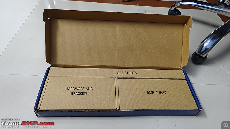

OUTER PACKAGING
DIY | Installation of a Gas Hood Strut Kit in my Scorpio-N | My take on its functionality-img_20241014_212307.jpg

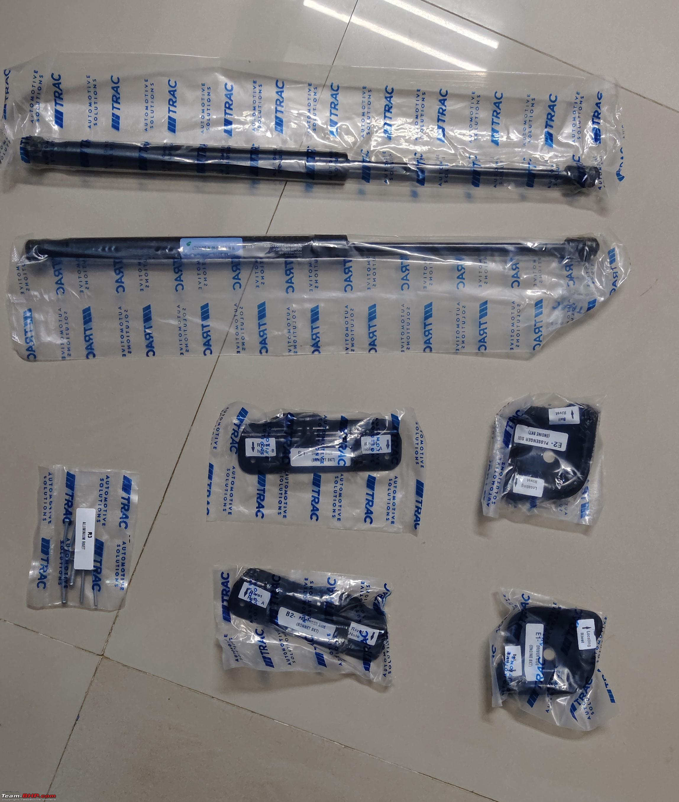

PACKAGE CONTENT
DIY | Installation of a Gas Hood Strut Kit in my Scorpio-N | My take on its functionality-img_20241014_212318.jpg
ALL THE COMPONENT INCLUDED IN THE PACKAGE

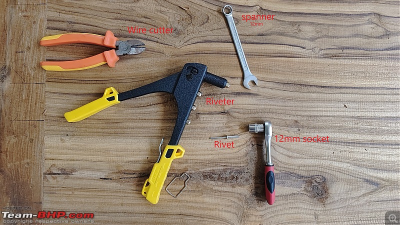

TOOLS REQUIRED

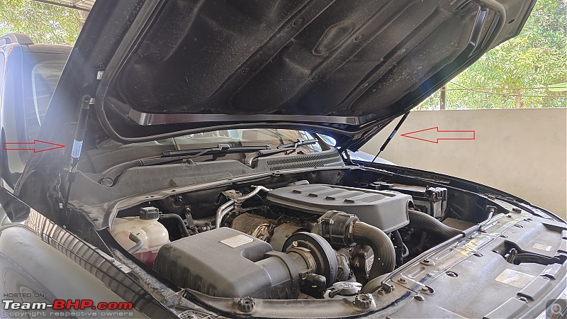

DIY | Installation of a Gas Hood Strut Kit in my Scorpio-N | My take on its functionality-img_20241019_122726.jpg
Cons:
1. Since the gas strut kit puts continuous pressure on the safety hook bracket, I’m concerned it may wear down over time.
2. It makes a loud “THUD” sound when I pull the hood release lever.
3. I now have to use some force to close the hood.
4. Is it really worth spending on something that remains out of sight?

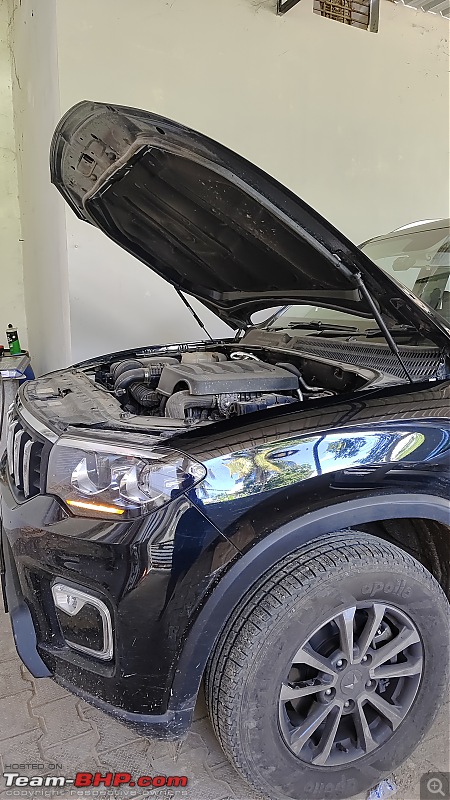

DIY | Installation of a Gas Hood Strut Kit in my Scorpio-N | My take on its functionality-img_20241019_122711.jpg
My Take:
Ever since I bought my Scorpio-N, I’ve wanted to install gas struts because they’re common in premium vehicles—even the Scorpio Classic has them. After the installation, I think it’s a fantastic feature to have and enjoy. However, is it necessary? Probably not, as I’ve only used it two or three times since installation. While I’m happy with the product and how it functions, I don’t think everyone needs one just for the sake of a slight change in convenience.
