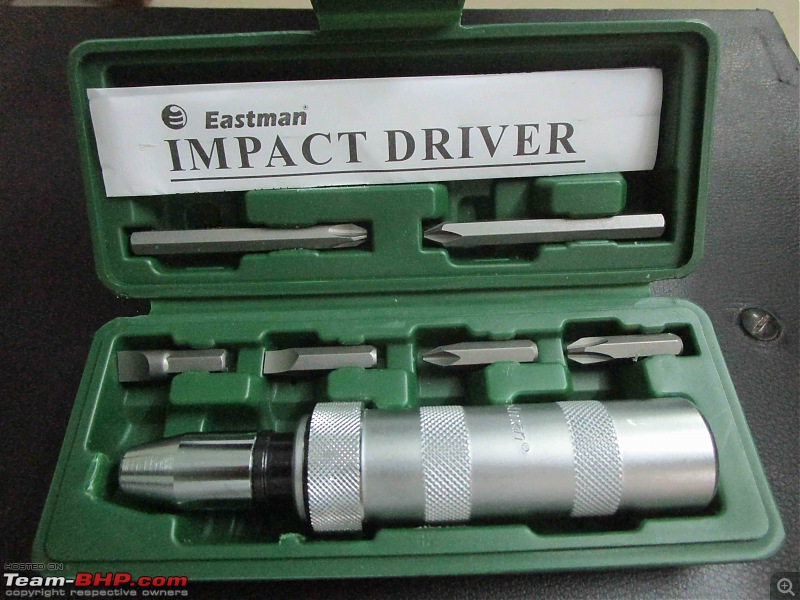

Brought an Impact Driver directly from Eastman Tools
Solid tool with unconditional life time warranty

Can be used with impact sockets as well

Originally Posted by adrian (Post 4165878)
Brought an Impact Driver directly from Eastman Tools ...
Stupid question, but I've always wondered and never actually see one used. How do you use it? Does the chuck/bit rotate when you hit it?
What kind of tasks do you expect to use this for?
It is particularly useful on seized screws/bolts. You just put it on with a bit that matches the screw/bolt head as closely possible and hit it with a hammer, like this:
https://youtu.be/Og0wilzMtXY
That's great. Thanks.
What do you hit it with: a hammer or a mallet?
One of the best tools in my box is a rawhide mallet --- for hitting things that should not be thumped with a piece of steel.
Lefty - loosy. Righty - tighty. :D
That's a good one.
Wonderful tool. Did not know that something like this existed. And I needed one just yesterday while installing my home theatre system. Would have saved me a lot of time.

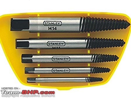

Is there any tool to unscrew a screw whose head has worn off?
For removing screws with worn out or sheared off heads, one option is a screw extractor, like the following (LINK):
The extractor is made from very hard metal, so it can grip the screw/bolt it is fitted into.
You'd first have to drill a suitably-sized hole with a drill, then screw in this extractor, and then turn the extractor (maybe with an impact driver, or just elbow grease) to remove the extractor and the screw.
The interesting thing is that the screw threads on an extractor go the other way (i.e. left turns tighten it) - this is to ensure that turning it to the left does not unscrew the extractor from the screw, but instead transfers that turning action to the problematic screw itself.
EDIT: WikiHow has a nice guide: http://www.wikihow.com/Use-a-Screw-Extractor
You use a hammer, steel on steel is required!
Arunphilip gave a good answer and a handy tool.
In the thread about my tools I showed a slightly different tool that doesn’t require drilling first!

I used these impact wrenches while maintaining my bikes back in the '80s before power wrenches came into general availability in this country. Came in most useful for screws that were locked in place over time by heat. Best to use an impact driver to loosen the fastener instead of to trying to unscrew with a normal screwdriver and in the process strip the head. I found impact wrench are most effective with Philips head screws. One needs to be a bit more careful with slot head screws.
The screw extractor/removal tool is something I need to add to my humble toolkit :)
