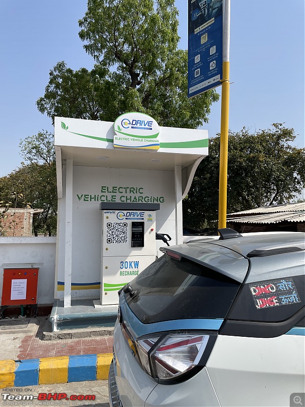

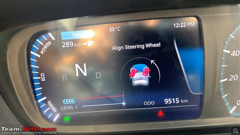

Altough I faced a tough situation at BPCL Nikhil Fuel on a LKO-PRYJ-LKO trip. The initial plan was for my parents to pick me from college hostel on 6th in PRYJ after a brief charging halt at the said DCFC which other people had already checked into previously on plugshare.
The car was able to charge successfully from 39% to 100% but upon removing the gun and starting, it flashed the HV Critical Error. Despite sincere help from @darthveda over reddit DMs, we were unable to start the car and it had to be RSA'd back to LKO. The car got all errors cleared and returned back from SC the very next day (since it was already noon when the error occured and almost evening by the time we reached back)
Been working fine since then and in fact, we took it on another excursion on sunday (9th) which I shall detail in another post. All happened within span of 3 days. The SC itself concured with @darthveda later on 7th, that it might be possible that the charger hardware may not be upto the mark - today we got a call from the pump folks too - an apology of sorts (they helped a lot while we were stuck there and gave a cell number to call in case we needed to verify charger status before headin out) - that the charger had some earthing issue apparently, which was diagnosed by the engineers from the charger manufacturer after our car got error and towed on 6th.
Lets see how it pans out. I must also thank @darthveda again for his help over reddit DMs
Before starting charging
BHPians experience on EV Charging Stations across India (especially non-metros)-eea6029526e24ef199558db5932b26cf.jpeg
After charging ended
BHPians experience on EV Charging Stations across India (especially non-metros)-2b316ad3bc4347d598309f12a967ffa5.jpeg
General word of advice as received from @darthveda and previous teambhp posts if you're a Tata EV owner finding themselves at a BPCL DCFC with HV Critical error :
1. Don't charge to 100% (this was my fault as I should've warned them not to charge fully on DCFC not only from time tradeoff but also from perspective of public charger etiquette)
2. Follow the 3 step start - Start button w/o brake pressed to go into ACC, Start button w/o brake again to go into IGN mode and finally Start button WITH brake pedal to start car
3. If you do get error, try to remove, wait 5-10min and reattach the -ve terminal of aux battery under the hood.
4. If possible, get a OBD2 Scanner which works with bluetooth to clear errors yourself in emergency situations.
Not only that. From many threads here and also on other sources, it is advisable not to charge to 100% on DC chargers as most of the HV critical errors popped up after charging on DC for 100%. Seems hardware used by some of the CPOs are causing issues when charged to 100%. I just don't take chances. I charge only upto higher 80s and move on. Only when the charger is absolutely free with no one waiting, I charge up to 95%.
HappyRider is online now   (1) Thanks
Old 18th April 2023, 16:11   #120
Join Date: May 2019
Location: KL-40 | KA-03
Posts: 213
Thanked: 722 Times
Re: BHPians experience on EV Charging Stations across India (especially non-metros)
Since I too had an interesting experience which left me stranded, this comment intrigued me. Do you have any recommendation on the specific OBD2 scanner which might help, also on how we'd go about doing a reset? I was under the impression that this had to be done with some specific Tata equipment.
Any fellow EV owners have a hands on experience in using a general OBD scanner for this?
