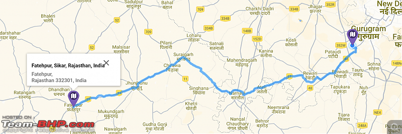

Report - Highway run of 546Km with achieved range of 515KM in 100% SOC
  1. Did a 546KM run from Gurgaon to Fatehpur,Sikar and back.
  2. Mode Used: Power Saving
  3. Regen: Auto-regen 100% of time.
  4. Air con mode: Regular (not Eco)
  5. Temperature set: 25c
  6. Style of driving: Trying to keep 90km/hr at all times. Only dropping when traffic or surroundings forcing me to drop speed. Overtook anyone who was below 90km/hr.
Got a range of 515Km in full 100% SOC(a bit better as I left with 97% SOC).

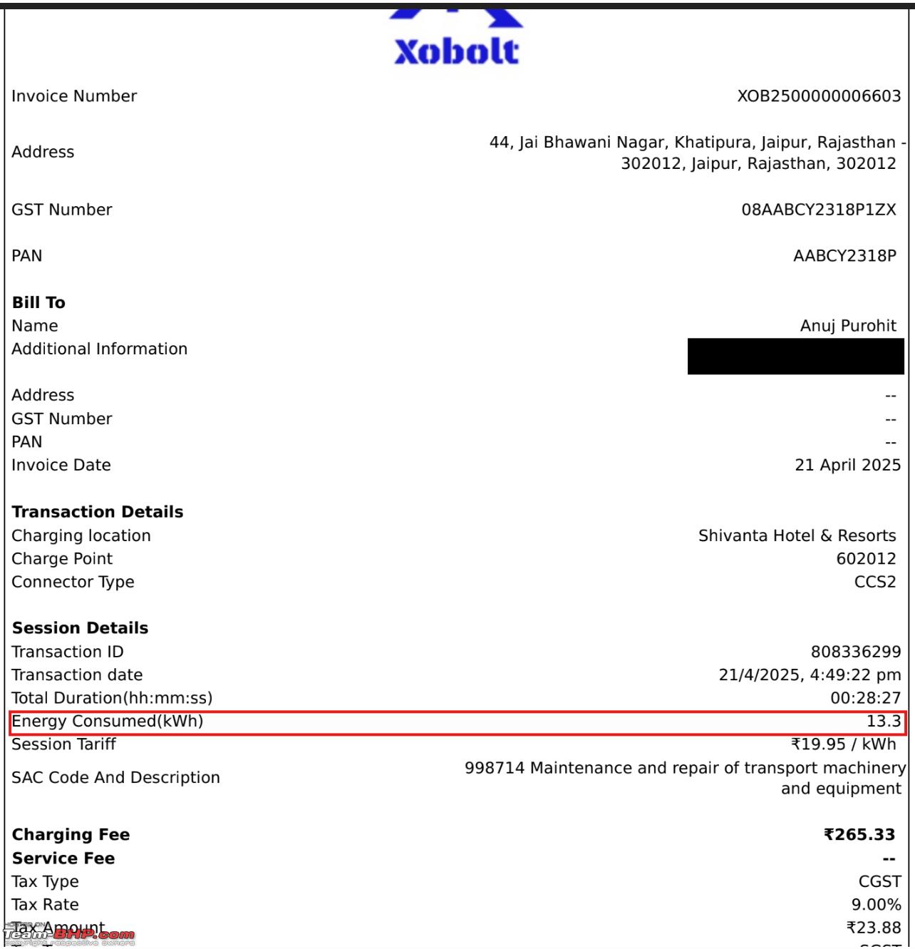

On the way back, saw an XOBOLT charger with auto-charge function. I wanted to test it, as I was not able to register for Autocharge with ChargeZone earlier.
Hence I wanted to see that it was the Car or CPO at fault.
  • Registered Autocharge in one go
  • Charger was charging at 30KW. One Tiago was also connected at 18KW
Topped ~13KW again. The car reported a gain of 15%.
Session details from the APP
Session details from the Car
Hence, total top-up of 44% in the entire trip
