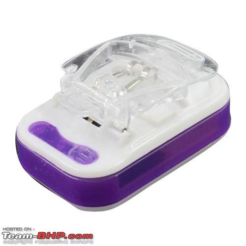

Solution 3 - Using those cheap universal mobile battery chargers.
1. Same as Solution 2. Should cost you anywhere between 50-100 at the neighborhood mobilewallah.
