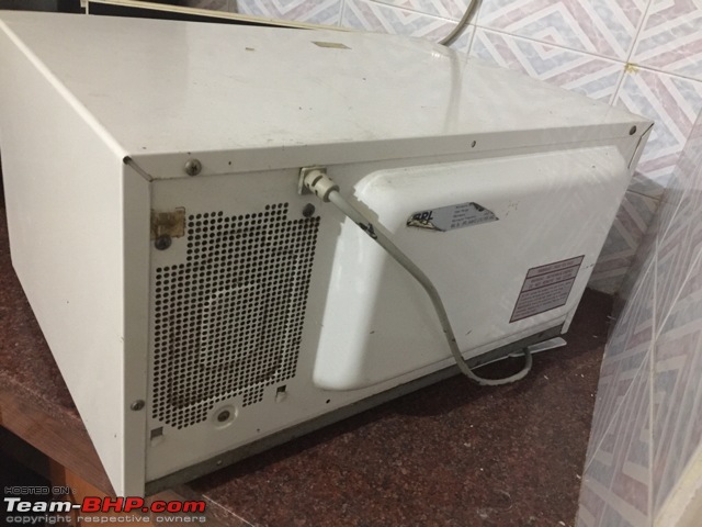

Our 17 year old microwave is giving some problem. We popped a popcorn packet last night and in between the second one it switched off. The unit was pretty hot to touch on the outside and failed to power on again. It worked again about 30 mins later, I suppose when it cooled off.
I am concerned about this body getting hot and want to know if this is normal? Ours is a BPL Sanyo model and is pretty large.

thanks for the reply. Yes the turn table is working. Did not notice the suction fan, will check it out. The unit is not covered but it is flush against the wall due to lack of space and its girth!
Just checked and there is air throw/flow behind the microwave where there seems to be a vent of some sort.
Malfunctioning thermostat seems to the be the culprit here.
If possible, share the pics of microwave (inside and outside) else take service support.
Originally Posted by kpzen (Post 3878963)
Malfunctioning thermostat seems to the be the culprit here.If possible, share the pics of microwave (inside and outside) else take service support.
How do I confirm if it is the thermostat? Not sure if these are the pics you suggested? Should I open it up?
The Home Appliance thread-imageuploadedbyteambhp1451326721.312848.jpgThe Home Appliance thread-imageuploadedbyteambhp1451326731.146188.jpg
Your microwave oven uses electronics control panel which means it uses an electronic component to sense the temperature and 'thermostat' is not the culprit here.
Simple technique to diagnose a faulty microwave oven is keep a glass bowl with about a glass of water (250 ml or thereabout) inside and turn on the oven with full power mode. Wait for a couple of minutes and it should be hot.
If it is hot your Magnetron - the heart of your microwave is good. If it overheats as it appears to do in your case, your glass of water may not be hot enough which may indicate a failing transformer. Before it dies, switch off and call a qualified service technician. It could save you a lot of money.
Usually a thermal fuse protects the high voltage transformer before it causes damage to components downstream. But if the oven had seen 'service' before, local 'technicians' short out the thermal fuse and invariably it results in damage to magetron and the HV diode.
