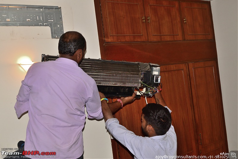

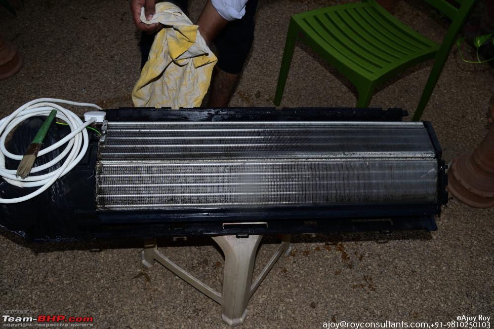

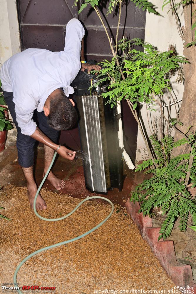

The saga of low efficiency continued even after the service. So I contacted LG and they sent an engineer. His verdict was that the fins in IDU were blocked and the whole unit will be dismantled, cleaned and then again assemble.

Close the outlet valve and run the compressor. All the gas goes into the compressor. Then close the inlet. Now there is no gas in the pipeline or IDU, all of it is in the ODU.
Drain the water in the tray. Even though the water is supposed to be drained, there was some accumulated due to mud, even though it was cleaned two days ago.
Disconnect all the pipes, and Take the IDU off the wall.
Note the clogged fins. The engineer agreed with me that for enhanced efficiency the fin spacing is reduced. That means that any dust that finds its way mixes with water in humid weather and jams the fins. The older AC had no such problems due to wider fin spacing.
Washed the IDU thoroughly. Same as with a window AC. A lot of mud came out.
Compare the fins they are clean and shiny.

Back to the wall. Connect the pipes and the AC is functional.
After thorough cleaning the AC is as good as new as far as cooling goes. What bothers me is that if this can happen in a year of service, I may have to undertake the exercise at least every alternate year. As I have 5 years extended warranty cum service contract it is all free now. But what after 5 years?
Aroy is offline

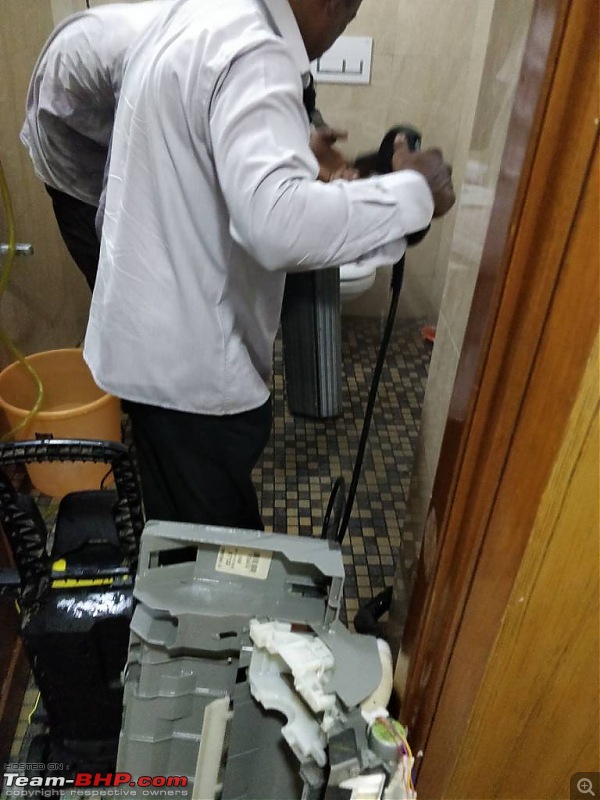

I got this done two months back by a known mechanic and he used a pressure washer on the IDU. He was a bit careless and dropped some plastic pieces and one side lock for the roller broke. He also damaged the joint of the IDU copper to the extended copper leading to a gas leak. These are somethings one needs to be careful about. But the performance is top notch now after this sort of cleaning.
