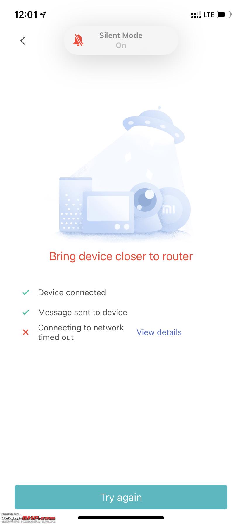

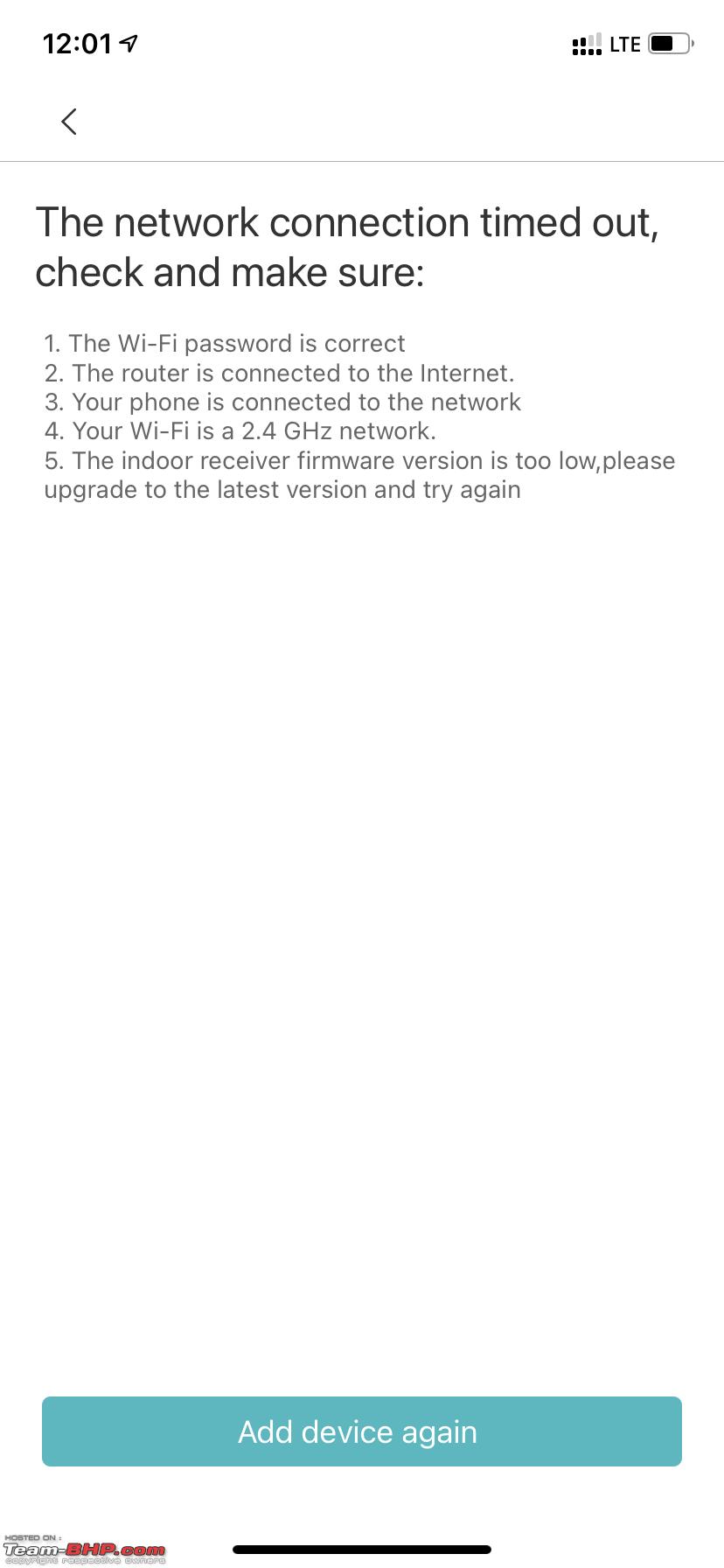

Hi Folks, need some help. I bought the Mi Robotic Vaccum thru mi.com and it was delivered to me just this morning. However I’m facing some set up related issues. I have downloaded the mi home app and have been trying to connect the device to my phone. However I keep getting an error message and it says that the firmware is too low and needs to be updated. But there is no way to update the firmware until the device is added to the mi home app. So I’m not sure how to get this to connect. I reached out to the customer care and after a lengthy call in trying to reset setting etc, there has been no solution. And now due to the extended lock down in Bangalore I cannot get a service executive until the 8th of June.
Please let me know if any of you faced this issue and if there is anyway around it. For reference i use Jio fiber network and have tried to use only the 2ghz bandwidth since the mi home says that only 2.4 GHz can be used. And I’m using an iPhone to connect the mi robotic vaccum.
Same pinch. Mine got delivered this morning too and more or less, I’m facing the same issue/error. Although a lot of reviews state that you don’t need an Internet connection to use this device but as of now, I’m thinking that an Internet connection is ‘almost’ mandatory especially while setting up the device. This is what I did to get it going:
Just like you, I was not able to get this thing added to the MI home app. Finally I made use of 2 phones as a work around because I do not have a WiFi broadband connection. I created a hotspot on phone 2 while the mi app was installed on phone 1 (again iPhone).
Don’t connect your phone 1 to the hotspot and keep using cellular data and then initiate adding the device on phone 1. When it asks for WiFi details, input the WiFi name and password of the hotspot running on phone 2.
Your device should now be connected and you can get it to work.
But many reviews suggest that the device doesn’t need Internet connection and can work just with the same WiFi as that of your phone connected over a router. I tried this over a Belkin wireless router but I’m unable to get it working as of now. Hope someone can point me to a proper solution.
Trust this will help.

I also had some issues connecting the mop initially. I can remember exactly how I solved it though. I think what I did was connect the robot and base station to the wifi using the wps button on the router and pressing both buttons on the mop. Then I think I ran the mop manually in auto mode by pressing the button and allowing it to do it's exploration. I think it was only after this that I could detect the mop in the Mi Home App possibly by being on the same wifi router as the mop or by using my mobile internet with wifi connection disabled on the phone. After that I could run it and the actual map of the house was created. Hope this helps

That helps! Please let me know if your WiFi router was connected to the internet or just the WiFi network of a wireless router (without internet) gets the job done?
Thanks!

It was connected to the net. Actually it's the range extender for my main Wifi router and it's the most centrally placed access point and the one closest to the mops base station. It does occasionally go into a sleep mode if idle for some time or if a couple of room doors are closed in between. It happens often enough so I can't say for sure what the status was at the time but it was most likely connected to the net

So what I’ve gathered after doing rounds on the Internet is that one will need Internet to configure the device in the mi home app. Once the device is setup, you can use the power button to clean the entire house without Internet as well. It will probably ‘remember’ the map of your house. But the app offers a lot of additional features that you may need frequently like dividing rooms, toggling between mopping or vacuuming mode, cleaning of particular room, spot cleaning, restricting some areas etc. For using the app, you will need the Internet as it will connect to the cloud service. So, in a way, the robot is dependent on the cloud service of Mi and we are at the mercy of same to keep it running.
