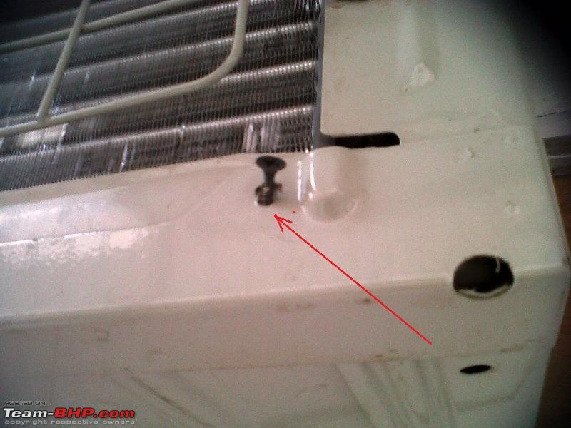

I have a Hitachi 1.5 T QC 5 Star. I also faced similar issues when the wet service was done 2 weeks back after kicking Hitachi customer care like (for which I have provided another review on 10th May that why someone need to avoid Hitachi for the pathetic after-sales services).
Anyways, first I thought it is some sparking (electrical work in my rented apartment is pathetic) or voltage fluctuations which is common in Gurgaon. But I realized nothing else is showing a real sign of that.
First, I replaced the round shaped power plug and got a new one to exclude chances of sparking.
Next I checked the way AC unit, which is sort of a cartridge, is placed inside the outside metal cover which is fixed on the window/wall. You might have seen that service guys pull the inner main unit from the outside cover and after service/cleaning is done, they push it back in that. What they do not normally check is that whether it is properly placed on the cover or not.
Now this is what I found.
I realized that compressor coils were touching the outer metal cover at few places. See here:
Using a screw-drive, I aligned the internal unit:
and used a screw to keep it there:
Finally I put some rubber pads where the internal body sits on outer metal cover (which is mounted on the wall/window and stays there permanently). Simple rule, when two metal parts are sitting on one another, if one shakes (when Compressor cut-off due to thermostat, it create a jerk. That is enough to make 2 metal body parts sing a song):
And bingo, no more irritating noise from my AC anymore. Earlier I used to be concerned that so much of fluctuating noises from the compressor may damage it permanently. Now I have a peaceful sleep
Good luck and let me know if description is not clear or you can't make anything out from the picture I have attached.

@Pallavi, @Anup, @amitpunjani:
sorry friends and thanks to you all for reporting the missing picture matter. Here find the same for ready reference. I have numbered them as 1-2-3-4 so that you can co-relate them to my post on the subject. Very surprising that when Amit quoted my message here, I can see my pictures on the quoted message as well beside the original one posted by me. Don't know whether it is some cache on my laptop or what but I can still see the pictures.
In any case, here are they attached again.
Inconvenience regretted.
regards,
Dharmesh
