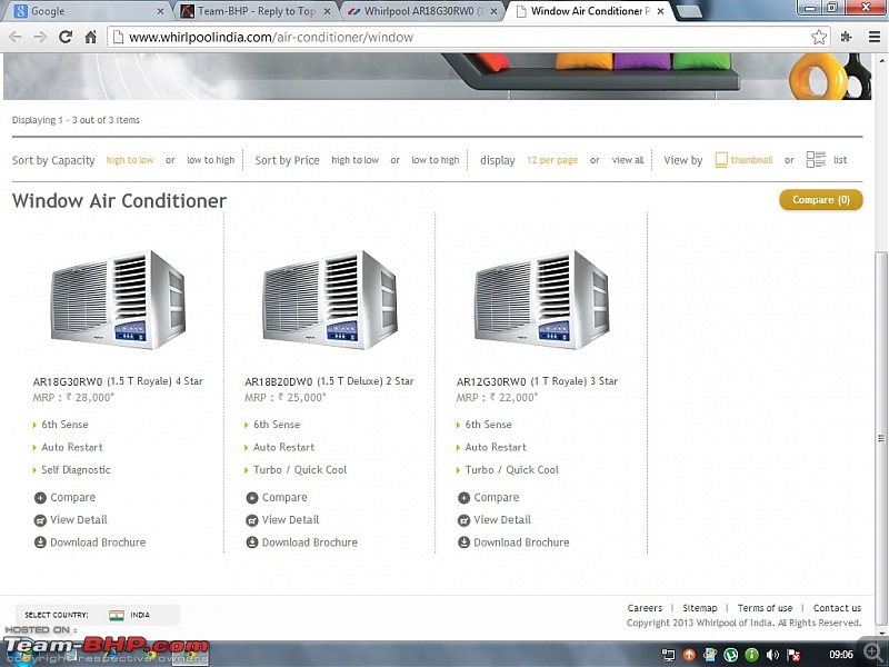

Need advice in buying an A/C urgently, based on the following requirements:
  • Window A/C
  • 1.5 Ton or 15000 btu/hr
  • Room Area: 160 sq. ft.
  • Room Height: 10 ft.
  • Room at ground floor.
  • No side has any sun coming directly
  • Total glass area: 2* (24 sq. ft. ) = 48 sq. ft.
  • Temperature at req. location : 42+
  • Temperature A/C will run at for most of the time: 25-26
  • Humidity levels: 70-80 %
Budget: Less than Rs. 25000
[*]Window A/C[*]1.5 Ton or 15000 btu/hr
[*]Room Area: 160 sq. ft.[*]Room Height: 10 ft.[*]Room at ground floor.[*]No side has any sun coming directly[*]Total glass area: 2* (24 sq. ft. ) = 48 sq. ft.
[*]Temperature at req. location : 42+[*]Temperature A/C will run at for most of the time: 25-26[*]Humidity levels: 70-80 %
The best window unit in your budget is the whirlpool 4 star royale @ approx 25.5k.
Can you provide a link please? The official site lists only these three:
The home / office air-conditioner thread-sda.jpg
searchingheaven is offline
Its the first one.call up the customer care and find the dealer for your area.
