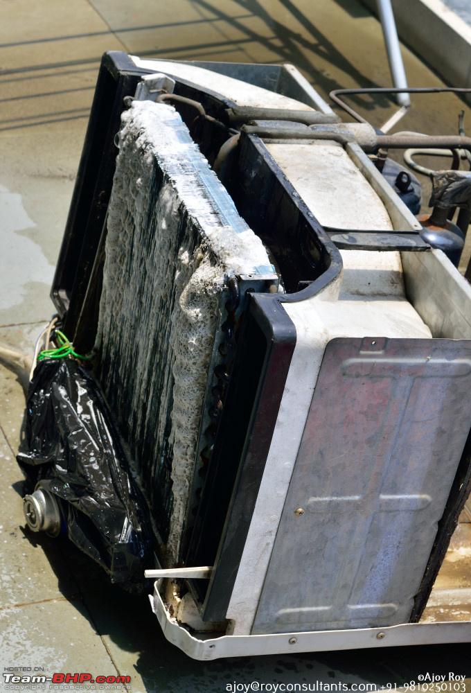

I had got My Hitachi AC serviced by the company in end March, but the cooling was way below normal. The fan throw was low and the cooling horrible, even though at the outlet the temperature was 15 degrees, the room would not cool below 33. Last year it was cooling down to 26 in the same conditions.
So I called my trusted AC mechanic and he diagnosed (as I had) that the coils were choked with dirt and that the "Company Service" had done an extremely shoddy job. He used a cleaning agent and here are the images - quite revealing.
The home / office air-conditioner thread-gsc_2947.jpg
Note the choked coil at the hot end

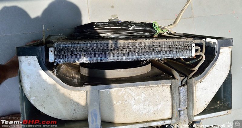

The home / office air-conditioner thread-gsc_2948.jpg
Choked coil at the front - cold side

The reason I am putting the images is that I have experienced a lack of professionalism from the company technicians (and at times propensity to changing parts for no reason), especially AC technicians. Considering that they charge 750/ per window AC; while the local guys charge only 300, and in some places 250/; it is a big scam.
